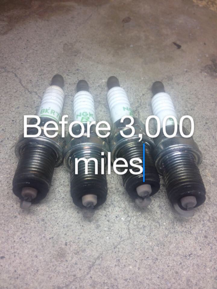

Hello. I was looking into getting my turbo rebuilt. Prior to installation I want to determine the cause of my failed turbocharger, if in fact that is the issue I'm dealing with.
Symptoms:
-Oil loss
-oil at compressor inlet and outlet
-small puff of smoke at sudden WOT
-oil spray out BOV on long drives
-no oil in catch can
-compression and leakdown test satisfactory
-no oil fouled spark plugs
Setup:
-1.6L 4age 16v
-garrett gt2560r
-closed crankcase breather system from intake valve cover vent to catch can to air intake
-#3 line with .035 restrictor
-#10 drain hose to top of oil sump (slightly higher than oem oil cooler drain) <15 degrees CHRA turbo clock tilt
Since I am not oil fouling plugs, my guess is that the turbo failed due to either: 1. Excessive oil pressure to turbo (but I have the correct restrictor, right?) or 2. Oil not draining properly.
1. I suppose I can measure lpm with the drain disconnected to see if I'm getting too much oil to the turbo
2. Is the full line on the dipstick lower than the oem oil cooler drain and not allowing oil to drain completely from the line? And/or is excessive crankcase pressure not allowing oil to drain?
If you have any other questions about my setup or symptoms, please let me know. I've done my best to try and diagnose the problem. I just don't want to install another turbo, and have it fail without knowing the cause of the first one.
Thank you.

its seems as though it is, but what do you think caused this?
is the oem oil cooler drain on the pan lower than the "full" level on the dipstick?
does anyone know what oil pressure is with a toga high volume pump? im not too sure im overpressurizing my oil feed to the turbo with a .035 restrictor...
is crankcase pressure too high with the turbo and stock valver cover vent?

As far as the oil cooler drain goes, I was just using it as a location reference. I have a #10 fitting on the turbo, and a #10 bung on the pan slightly above the oem oil cooler drain (as high up as it's possible to weld and still tighten the 10mm bolts for the pan..)
Is this location above the "full" level on the dipstick?
Thanks for the info on the toga pump. I guess I'll never get another again.. Pressure seems normal on my stock gauge anyway, so I'm assuming a stock oil pump is sufficient for my setup if it happens to be what's actually in there.
Assuming I am running a stock oil pump, is it possible my turbo failed because of excessive oil pressure to the turbo with a #3 line and a .035 garrett b/b oil restrictor- resulting in oil not draining fast enough?
Crankcase pressure can also inable oil draining. Do turbo systems benefit from a vented breather system opposed to the closed system from the factory?

breather system=. Vent->catch can->intake w/ factory hose on intake manifold plugged.
No, I don't need to tie down my dipstick.
I agree that the seals on the turbo are the probable cause of oil loss due to failed seal(s), but is it because :
Oil drain is too low?
->>is the oem oil cooler drain hole higher than the "full" mark on the dipstick?
Mine is located as high up as possible on the pan directly above where that hole used to be.
If my crankcase is getting over pressurized, what indications would I have?
->> is my breather system inadequate now due to boost?
->> will the added vent on the. Exhaust cam and/or a vent on the catch can help?
First I want to be sure the turbo failed, but I will only know once it's disassembled.
Assuming it failed, due to my setup, what is the probable cause?
