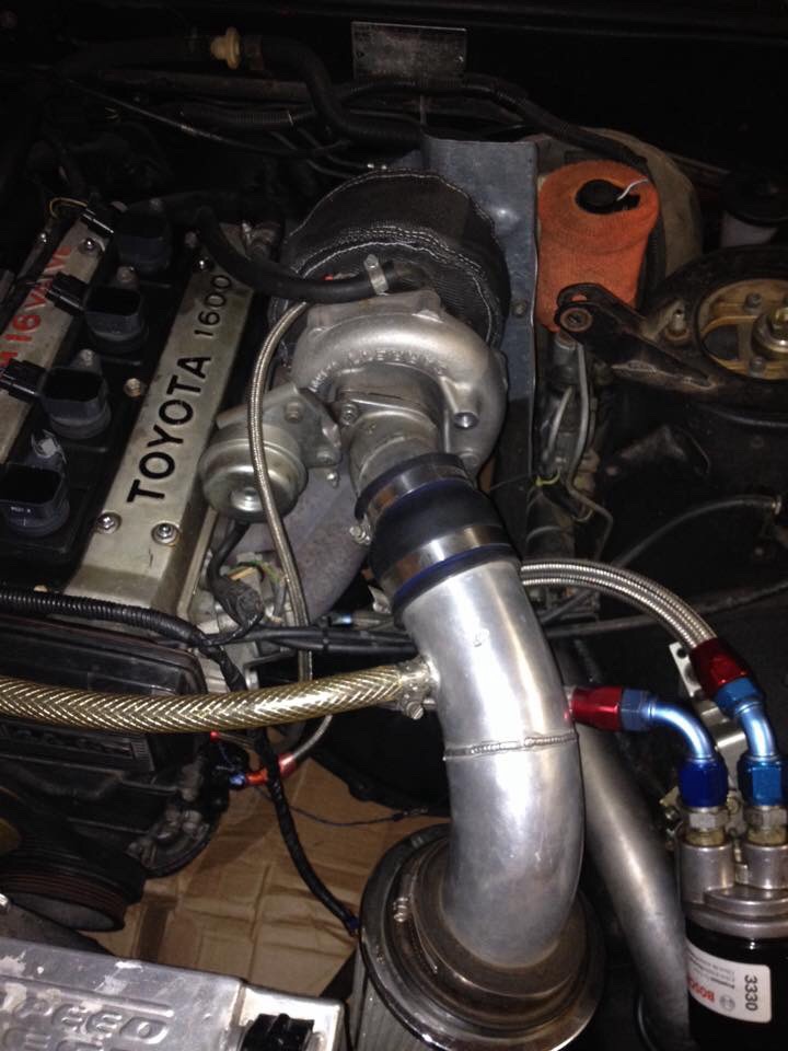

Hello. I was looking into getting my turbo rebuilt. Prior to installation I want to determine the cause of my failed turbocharger, if in fact that is the issue I'm dealing with.
Symptoms:
-Oil loss
-oil at compressor inlet and outlet
-small puff of smoke at sudden WOT
-oil spray out BOV on long drives
-no oil in catch can

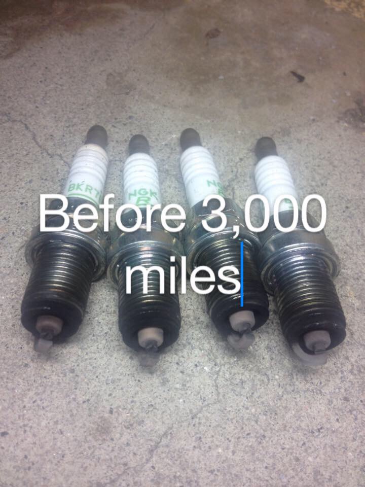

-compression and leakdown test satisfactory
-no oil fouled spark plugs

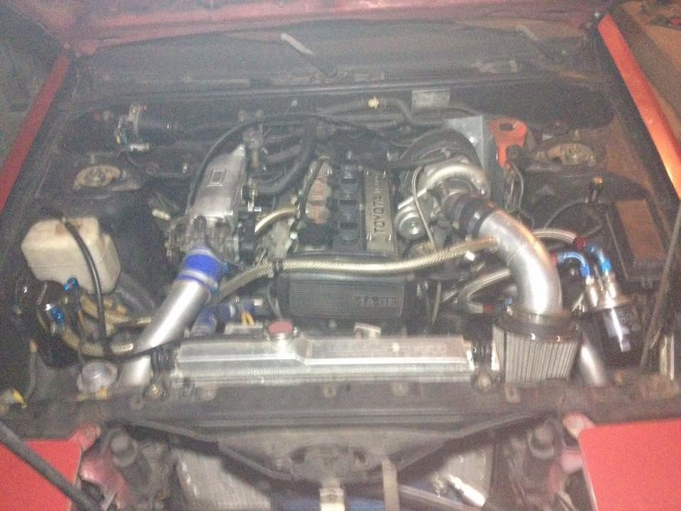

Setup:
-1.6L 4age 16v
-garrett gt2560r
-closed crankcase breather system from intake valve cover vent to catch can to air intake
-#3 line with .035 restrictor
-#10 drain hose to top of oil sump (slightly higher than oem oil cooler drain) <15 degrees CHRA turbo clock tilt
Since I am not oil fouling plugs, my guess is that the turbo failed due to either: 1. Excessive oil pressure to turbo (but I have the correct restrictor, right?) or 2. Oil not draining properly.
1. I suppose I can measure lpm with the drain disconnected to see if I'm getting too much oil to the turbo
2. Is the full line on the dipstick lower than the oem oil cooler drain and not allowing oil to drain completely from the line? And/or is excessive crankcase pressure not allowing oil to drain?
If you have any other questions about my setup or symptoms, please let me know. I've done my best to try and diagnose the problem. I just don't want to install another turbo, and have it fail without knowing the cause of the first one.
Thank you.

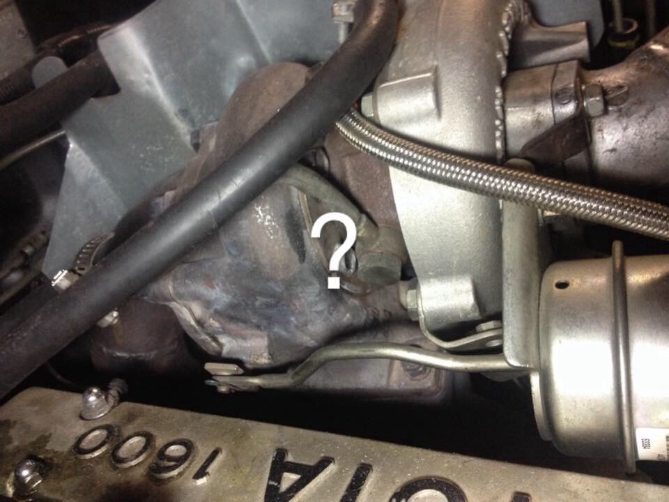

Hey, I'm not a turbo guy, but looking at this pic it seems that the only way oil can
get into the compressor side is thru the oil seal...
And if your blow-off valve is over by your catchcan, then your intercooler must
be full of oil as well. Small amounts of oil getting blown into the engine won't
result in oil fouled plugs, as the oil will just burn away when the engine is working.
And when it is off boost there won't be enough air velocity in the intake ducting
to drag oil into the engine.
The amount of blow-by that the engine generates varies with the cylinder pressure
and engine rpm. Going by what people do on high revving N.A. engines, you might
be pressurizing the crankcase at high rpm/high boost. Typically high revving N.A.
engines have a vent outlet welded onto each cam cover, with both hoses running
to the catchcan. Do you have to tie your dipstick down ?

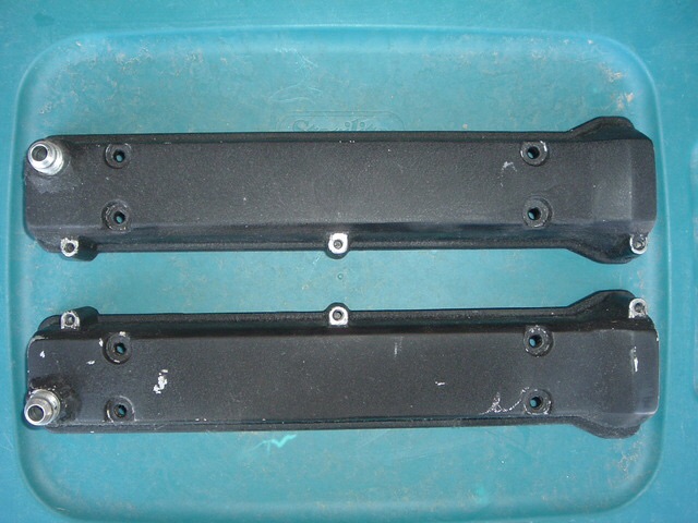

Re: 4AG Turbo oil loss ?
This is interesting....
http://charmant4age.blogspot.co.nz/2012 ... -line.html

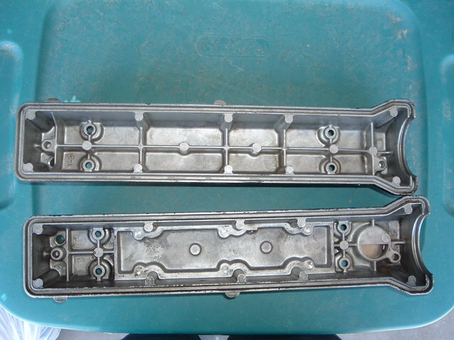

And see if you can lay your hands on a second intake side cam cover. As
a temporary thing, you could run that to give you the second vent hose.

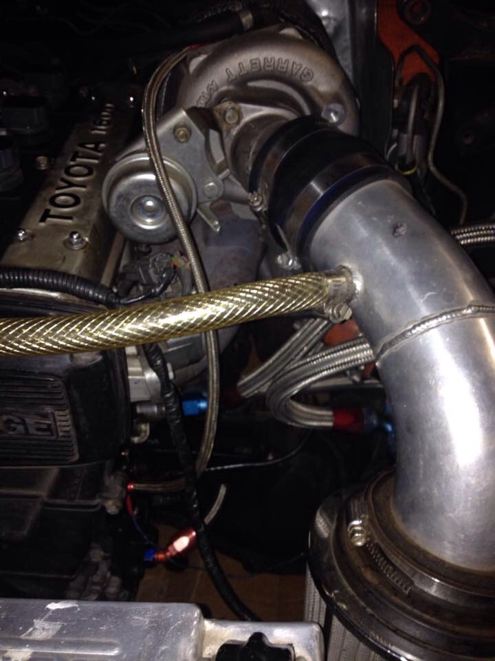

my oil drain is in the exact same spot as the picture jondee86 posted.the only difference being a #10 fitting and line. do you have an oil pump housing, dipstick, and tube to see how far down the dipstick actually sits in the sump? i am trying to figure out if the turbo oil drain location on the pan is higher than the "full" mark on my dipstick.
if oil isnt leaking out the drain, its got no where to go but to force itself out the seal(s).
i agree. another intake side cam cover would be a good alternative, but if the problem is an over pressurized crank, is the size of the fitting sufficient to relieve crankcase pressure? or would a larger opening in one or two covers do the trick?
or get the largest ID pc valve i could find and plumb that inline with the oil drain located on the back of the block on the intake side plumbed to the catch can.
or put a breather fitting on the oil fill cap plumbed to the catch can
or put a breather fitting on the oil fill cap plumbed to atmosphere

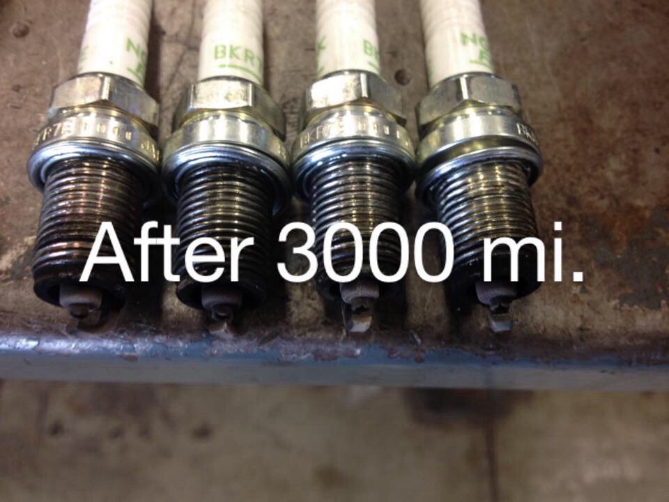

Should I just vent the catch can?
Is the oil pan drain fitting high enough? Higher than the "full"mark on the dipstick?
Oil feed is #3 hose fed directly from where the oil pressure sender used to be with a .035 restrict or at the turbo.

Is the intake oily between the PVC connection and the turbine?
Does the intake turbine wiggle?????????????????
What is the black hose on top of the turbo?
If you can find another RHS cam cover to use (temporarily) on the LHS of
the engine so you can use two vent hoses. Just run the ends into an empty
container (2 liter drink bottle) with an open top (vent to atmos). See if that
makes any difference.
Any of the other options can be made to work, but you have to baffle or
otherwise stop oil mist from being swept out the vent along with the gases.
Two RHS covers is easy, and two oil filler caps looks "different"

Please tell me that the large black hose running over the turbo to the back of the engine IS NOT the drain.
Na man. It's a coolant line.

what would be the correct way baffle these valve covers?
- Attachments
- image.jpg (98.2 KiB) Viewed 29112 times
- image.jpg (83.95 KiB) Viewed 29112 times
This is how one person made a baffle...
http://i1172.photobucket.com/albums/r576/4age_ke/DSCF1211_zps359539cb.jpg
http://i1172.photobucket.com/albums/r576/4age_ke/DSCF1212_zpscc3c0579.jpg
If I am not mistaken, you can see the factory baffle plate for the standard cam cover
vent in one of these pics. The idea is to stop oil being sprayed directly into the vent,
and to make the fumes travel sideways before they reach the vent, to allow drops of
oil to fall out of the airflow. There needs to be a gap between the baffle and any ribs
that it covers, so that fumes can reach the vent from both ends of the baffle plate.

With a good air /oil separator I don't think you'd need the baffles. Fwiw a cheap hollow catch can on a closed system doesn't really do anything.
I've got a better idea ince you're not use the oil drain on the block...
You could run those with a proper air /oil separator with 3 ports (2 inlet and 1 outlet), and a drain. Run a line from each valve cover to the can. Run the outlet to the intake before the turbo compressor. Hook the drain on the can to the oil drain on the block. Maintenance free. Also, this way crankcase pressure would also be able to escape through the block drain through the can. If you're worried about oil getting pushed out of the block through the oil drain, run a 1 way valve on the drain line from the can.
This isn't the subaru pcv system idea. That's even more complicated...
