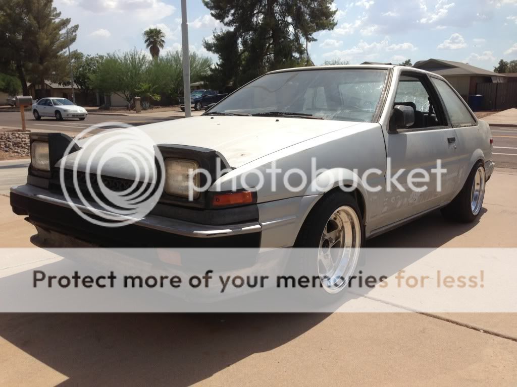

Soooo in lieu of all that, I'm finally to that tuning/test drive stage of my carb swap, keep in mind I've got Weber 45 DCOE's on a red top small port hi comp. My current settings here in PHX are:
- 35 chokes
- 70 IDLES!!!!!!!!!
- 150 mains
- 195 airs
- 45 pumps
- F16 emuls
I mean PHX does have high levels of ethanol in our fuel, guessing anywhere from 8-12%, but 70's freakin really?! MSD 6AL2, run retard set from 0-1000 curving 5-10deg BTDC, from there it curves up to a max of 30deg by 4500. Now, I got the carbs w/ 45 idles, got it to fire, sync'd n idling but when I snapped throttle it fell flat on its face. Roll into it slowly n she runs like a raped ape! Top end seems there or at least close. Tried 50's n 55's, nope... Got 60's n 65's, freakin awesome getting closer, like off idle if I laid into it she'd drop out. 70's are sooooo close but something still ain't right.
Current idle needle settings are:
-1. 3/4 out
-2. 7/8 out
-3. 1 1/8 out
-4. 5/8 out
Current idle screw settings don't make sense at all, but I think I got the EGT's somewhere around 60deg of variance from front to back. Speaking of which, does 550-600+deg taken at the exh man at the head, sound too hot? Either which way, a wideband is in the works very soon. In the mean time, I'm gonna do an ignition tune up on it, chk the old plugs, run compression n leak downs again, n order air filters.
Here's a teaser, build thread in the works...
