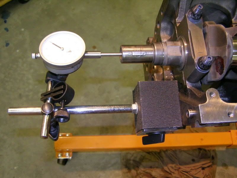

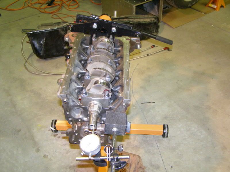

I would just pull the pan make sure there is no metal in the pan
Make sure it rotates freely check the thrust bearing play if that is all good I would call it good
Any more then this you might as well rebuild it
Thrust bearing check
Good luck
