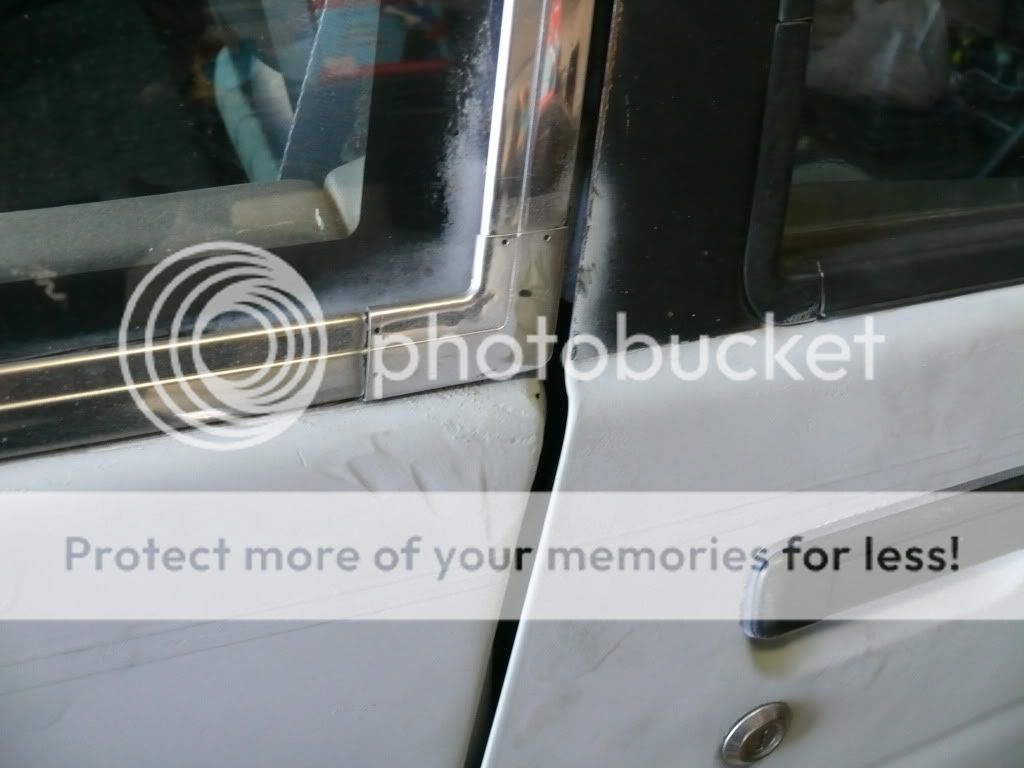

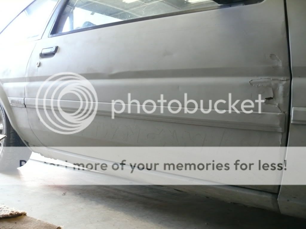

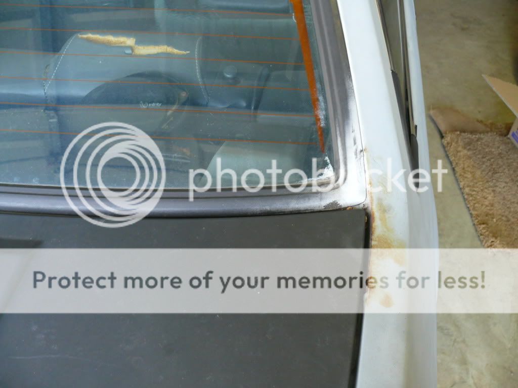

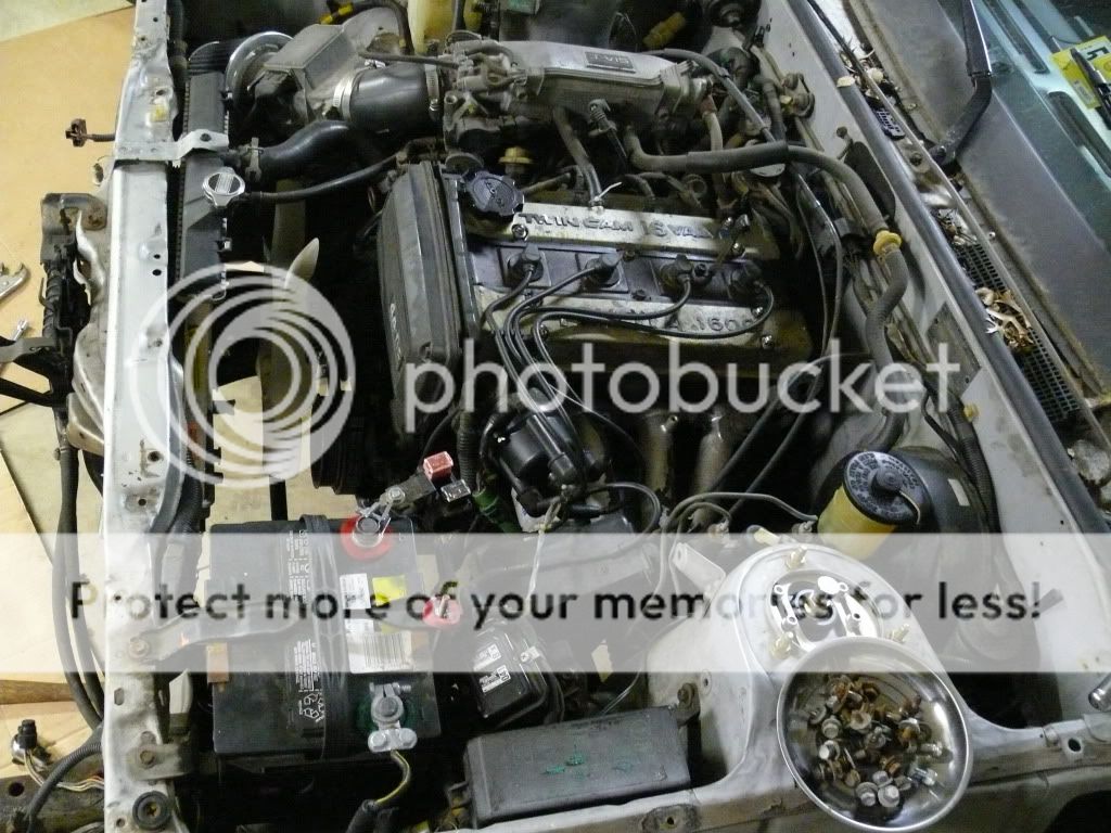

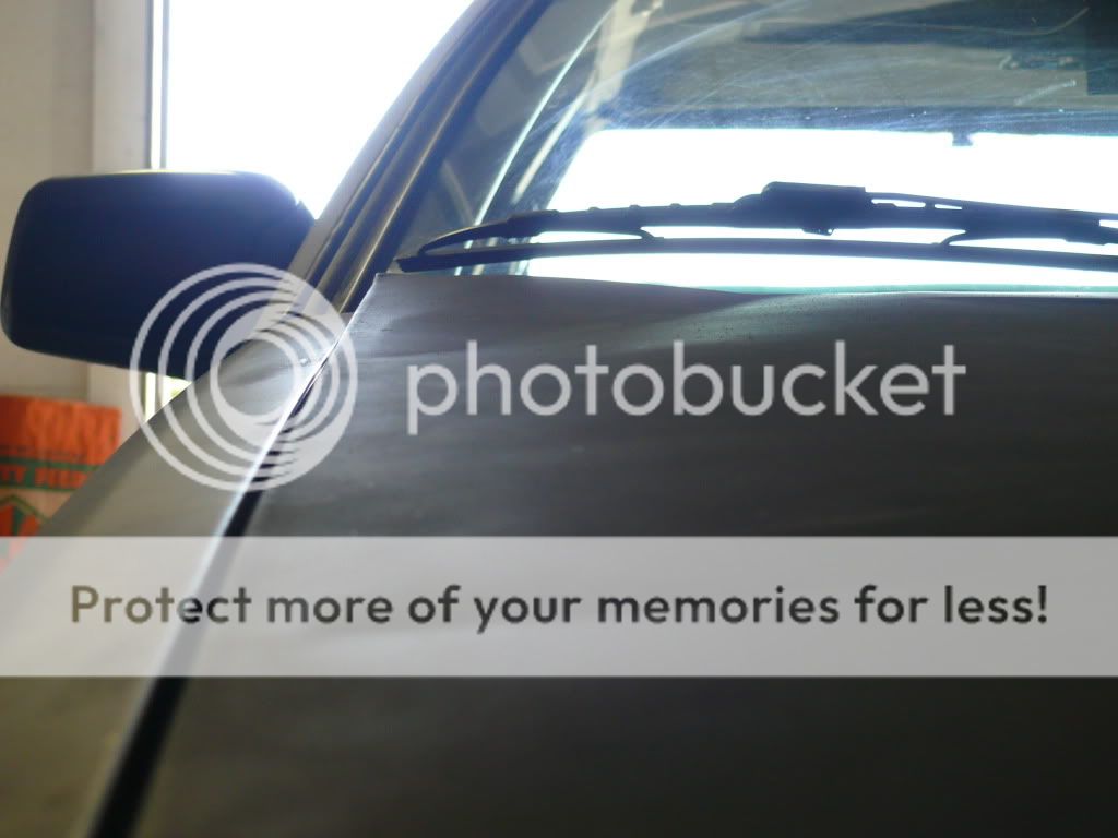

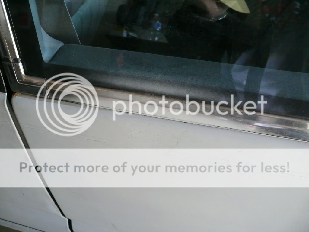

Instead of writing a letter, I'll post detailed pics of the headache of buying from someone who doesnt know how to deal with cars...
]I learned my lesson, if someone is selling a project car and you see signs of ghetto work done to it, DONT BUY IT. You're in for a world of headache when you find more stupid stuff pile up on the car...

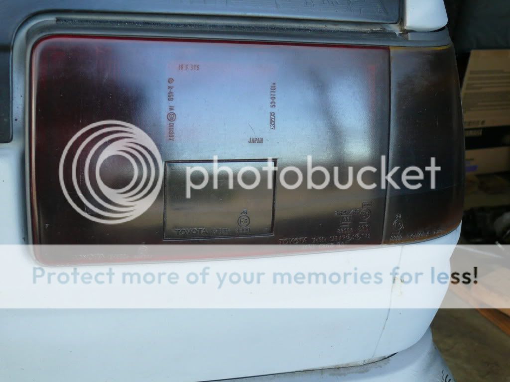

1- Primer overspray EVERYWHERE on glass and window trim, no taping up
Overspray on tinted tail lights as well (I removed all the black and restored the original look)

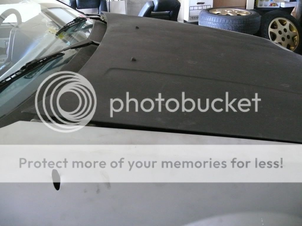

2- Hood spacers added and corners of hood were bent upwards to add more "hood vent flare" This was done by pry bars ON THE FENDER.

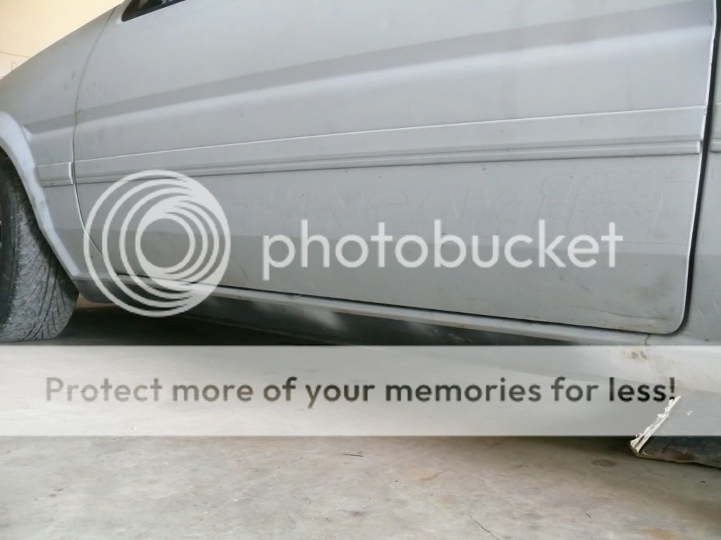

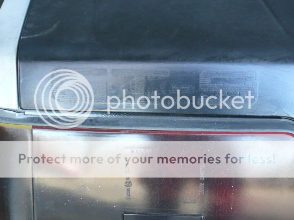

3- Primer OVER pinstriping and Twin Cam door decals and trunk (pressure washer took all the decals off, but now I have to sand a lot of primer off to smooth it up...)
You can see the wonders of using a pressure washer.

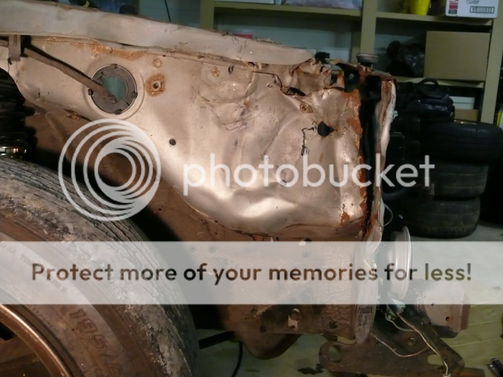

11- This car appears to have jumped onto a curb and bottomed out (possible street drifting in previous ownership) so the floor pan under the drivers seat is pushed up 3 inches into the cabin (I guarantee you that I'll be sledgehammering that bitch real soon) and the frame rails are pancaked flat in the same spot.

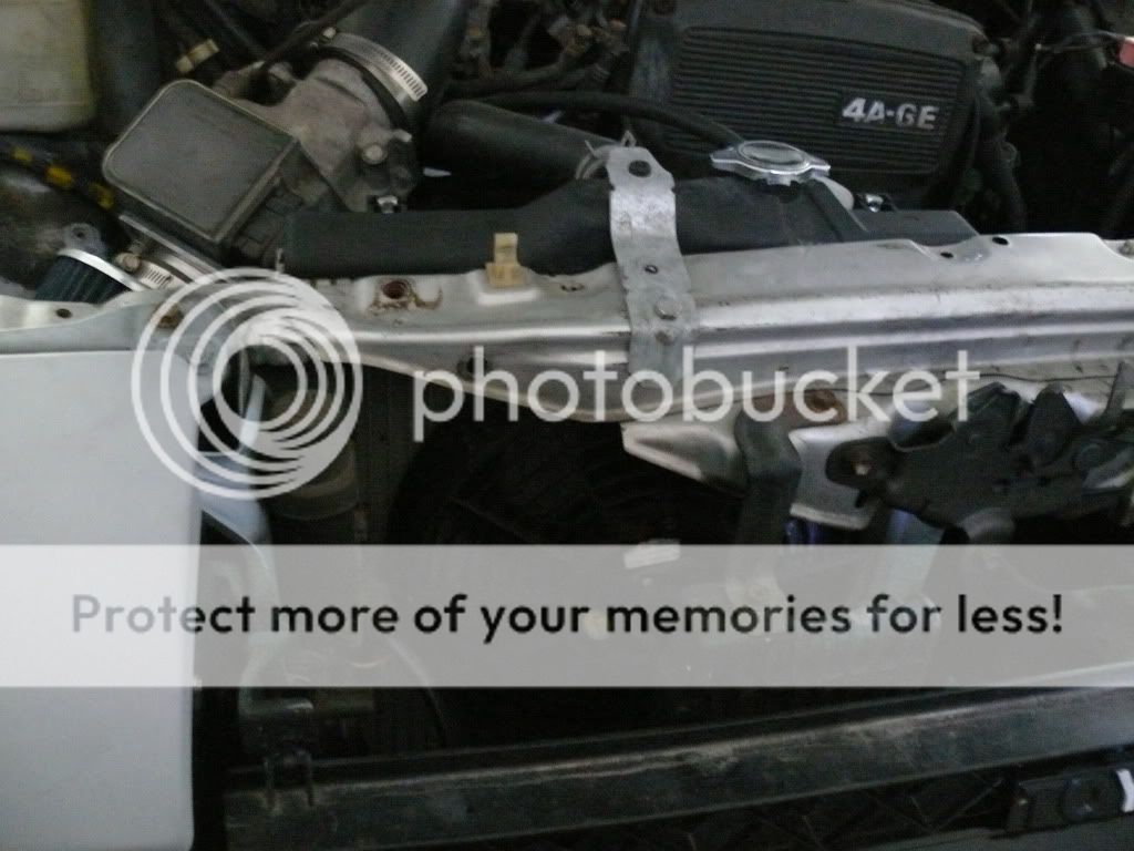

12- This car hit a pole by a previous owner street drifting, so the radiator support is damaged and frame is bent. THIS IS THE REASON THE CAR GOT PRIMERED. THis car was a beautiful one tone silver!

15- Idiot torched out the lower radiator mounts and installed a Civic radiator (blew my 4age due to overheating running drift events with HALF the coolant capacity than a standard Toyota limit...)
It's a work in progress, as I basically removed everything and installed parts from other cars that I trust, lol.
Painted engine bay and created a removable radiator support.
I re-primered the fender, which is why it looks different.
