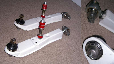

Installed a pair, adjusted to standard length.
Increased bump steer.
Any ideas anyone ?

Looking at your pic I would not be certain that those arms are made from OEM AE86
arms. So the attachment point for the tension rods could be different, and this might
have changed your caster angle ? I don't know if caster affects bump steer, so maybe
not an issue either.

Just to clarify, the picture was a generic one I found online but I will look closely at my LCA's anyway. Thanks for that idea Jondee.
