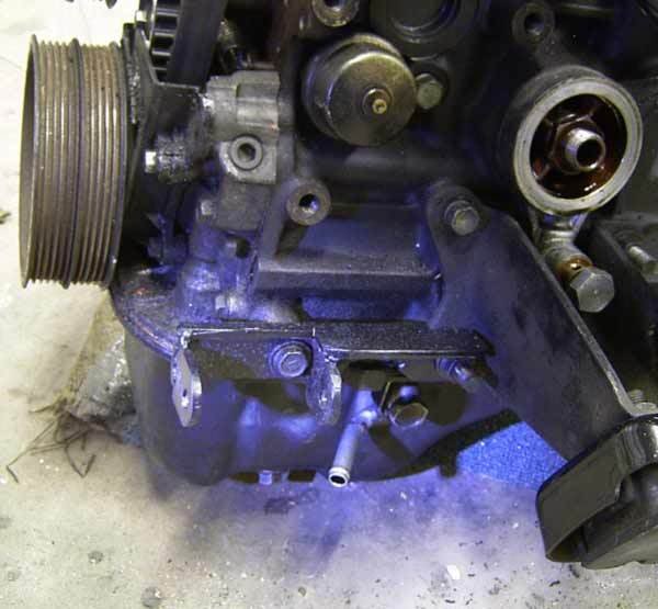

This is a solution offered by SQ Engineering that mounts the alternator low on the
exhaust side of the engine...
Perhaps if you could use the top part of the 4AGZE "multi-bracket" and the SQ bracket
for fixing the alternator to the block it might work. Tensioning would just be by using a
lever and then tightening a bolt... same as the stock AE86 alternator.
On second thoughts, I think you are heading into a minefield :) Apart from hanging the
alt and p/s pump off the side of the engine, you have to get the correct offset so that
the alt can use the outer row on the crank pulley. By pure fluke I was able to do that with
the AW11 non-a/c alt bracket and a stock RWD AE86 alt. But I didn't have a p/s pump
to worry about

Pic of the SQ alt bracket. As you can see it has been stepped at one end to resolve
the problem of the alt bracket and the engine mount sharing the same bolt.
And a pic of the AE92 4AGE smallport p/s bracket without the p/s pump.
And a pic of the side of an AE92 4AGE smallport block showing the bolt locations.
