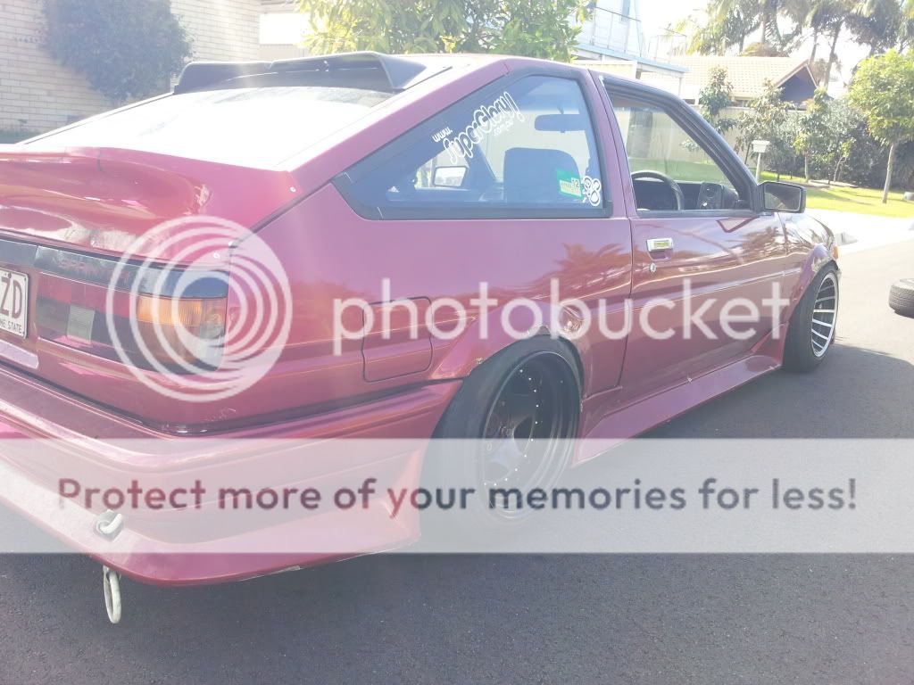

Hey, man. This is 15x10 0ET off an Aussie car.
I guess it should give you some idea?
It probably would stick out a good bit.

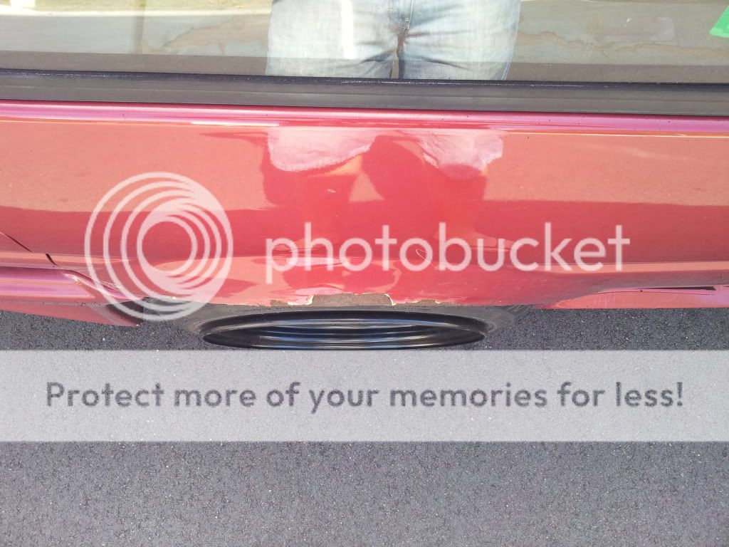

I decided after buying flares to copy the profile of the Jubride flares and make metal ones with my own style added to it. Here's how it is so far.
It was actually not as hard as I imagined it to be. What made it easier was tracing an existing flare set on some 22 gauge sheetmetal, cutting and grinding and then welding to the stock body location where the OEM flare would start (obviously cut the old fender guards where needed). Lots more grinding, sanding, puttying and then painting to go.

I traced out a copy of a rear Jubiride flare and somewhat used it as a rough outline. brought out the angle grinder and went to town.
Here's how it is right now. I trimmed a little bit more of the arch for clearance and added a slightly elongated arch to let tire smoke vent outside of the wheel well to the back of the car. My buddy calls it "scalloped". Whatever, it's cool! Also mounted the kouki rear bumper, trimmed the tabs in the corners a bit and played some more with fitment.
