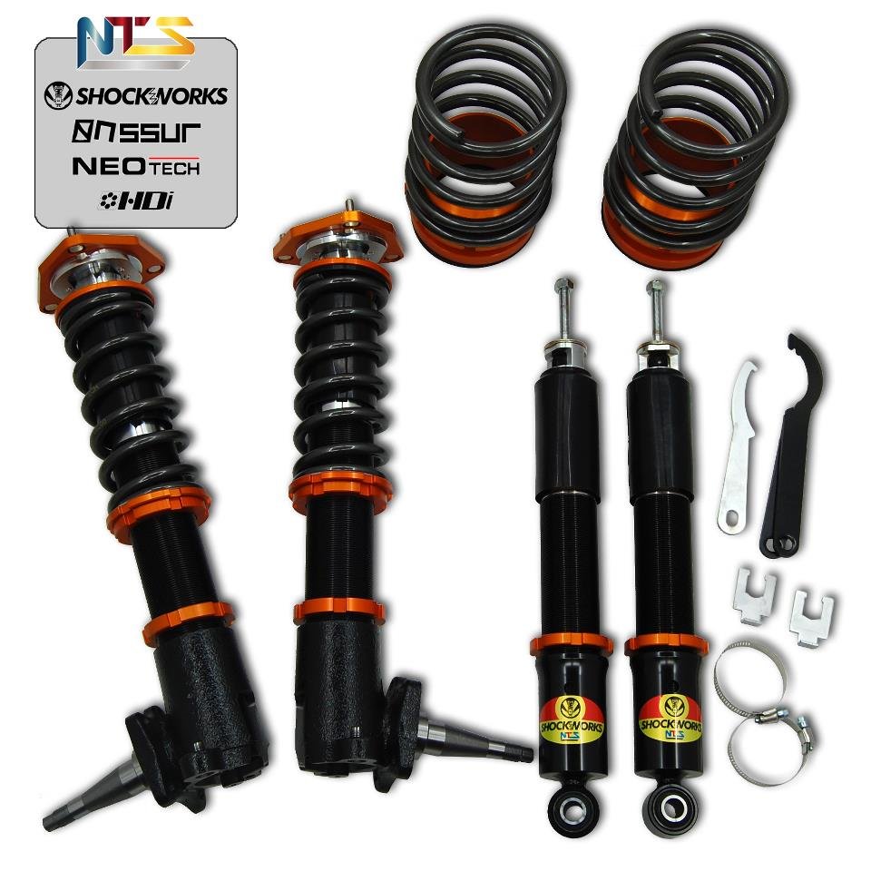

On paper I still think shockworks sounds the best. Monotube shocks (inverted front) with 6/4k spring rates. The best thing is they've properly tuned the valving for our cars (and spring rates) using math, shock dyno, and road tuning to get the most grip and soak up the bumps. The only problem is they're probably the most expensive kit out there, and they're located half way across the Earth in Australia.

My vote is with Stance. They did a lot of hands-on development with the AE86 and their newest inverted coilovers. I've talked with people that have run them and they do exactly what they should. They actually come with 8k front and 4k rear but they're also fully willing to consult on a custom setup for different spring rates so they can valve the shocks accordingly.

What sort of driving do you want to do with the car, and what's your budget? Having driven on all of those setups listed above (besides Fortune Auto) I found the Shockworks setup best, the damping is just worlds in front of everything else for ride comfort and outright grip.
They are more expensive, especially for you guys but were worth it to me as anything else felt like a compromise in comparison.
