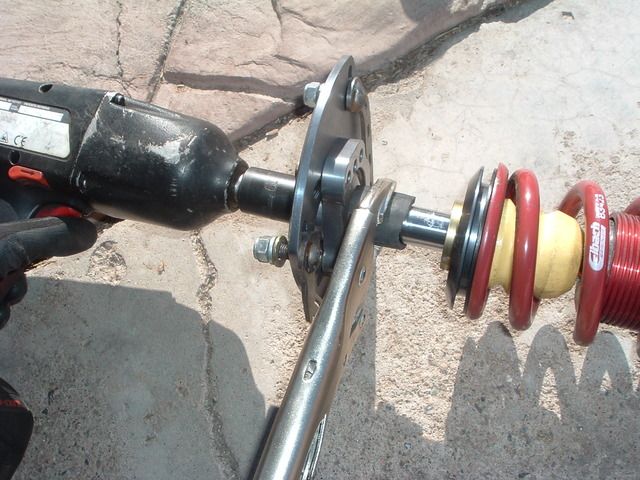

I still use an impact, but I also get a small and thick section of rubber hose to place around the very top of the shaft and hold it with some vice grips like this:
Damaging the shaft with the vice grips is a risk, and the shaft can still spin, but it seems to do the trick without damaging anything, especially if the nut is a little stubborn to break loose. Try at your own risk.
