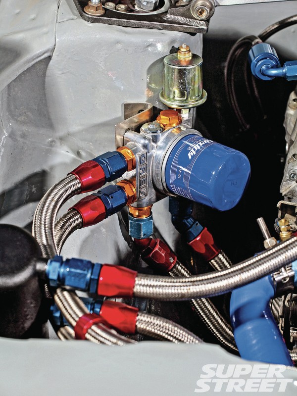

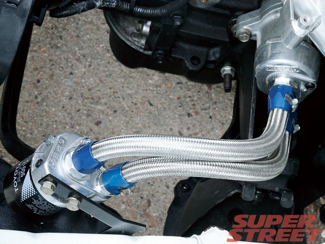

On a 4A-GE because of the location under the header (exhaust manifold) it is best to buy a relocation kit so that both filter, sensor plate/block, are out in a more accessible area for the sake of more accurate reading, as well as ease of oil filter changes, and sensor wire protection. Also a oil cooler line block can also stack on these so that everything is still easy access and have an in-line oil cooler as well.
[img]130_0612_09_z+1985_toyota_corolla_ae86+greddy_oil_filter_relocation_kit.jpg[/img]

So those are another engine and application but you get the point... They are usually made from pieces and a shop can put together various parts needed for a AE86 and 4A-GE applicaiton.
