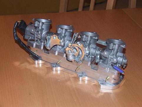

Re: ITB manifold
[offtopic} A long time ago when I first looked at doing the ITB conversion, I did
a bit of research on what adapters were available. First I wanted to use the whole ST
manifold as per the OST pics above... but no-one was selling adapters, and I had no way
of making one. So then I looked at the T3 adapter, and read that the inlet and outlet
sides of the adapter did not blend the angles very well, and that some porting would
be needed to get it to flow decently. RS Chita had a much nicer manifold, but wouldn't
ship them outside of Japan, so in the end I just made my own inlet manifold from tube.
What I really wanted was this, but there is not enough room to fit them on a RHD car
It's my opinion that it is better to have a bit of distance between the butterflys and the
valves, to let the airflow settle. And a nice smooth transition from throttle bore to
port shape, with the intake runner matching the angle of the port. [/offtopic]

Re: ITB manifold

Re: ITB manifold
gotzoom? wrote:Did you waterjet the flange on the itb manifold side? How did you arrive at the
tube length of the adapter manifold?
There wasn't a lot of science involved
both the flanges waterjet cut. Then I used aluminum scaffold tube, which I calculated
to have the right diameter to match the intake ports when squashed down. Put a curve
in it with a pipe bender which partially collapsed the tube into almost the exact port
shape. Cut the U-bends in half, then a bit of massaging in a press and good enough.
The length was pure chance... I just needed them to be long enough clear some of
the stuff on the intake side on a RHD car, and tilt the throttles up a bit. Due to some
brain fade at the time of welding up, the TPS ended up in front instead of at the back,
as I had intended. But happily, that mistake actually working in my favour... space is
awful tight at the rear of the head.
I did look at the calculations for tuning the intake tract for a particular rpm. But came
to the conclusion that when the engine is required to work over a wide range of speeds
and space is limited, the harmonics you are trying to catch are not significant. If you
have the room you can experiment with stack lengths. I have finished up with very
short stacks, and they work well. Probably because I have more inlet runner length.
