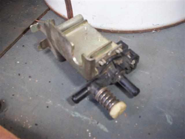

Ok, so I bought a AC idle from a forum member and got it today.
Swapped it in, and it does the same thing. Still of I adjust the screw it will bring the idle rpm up or bring it down when the AC is OFF.
But I spotted a plug that was not plug into anything (the yellow one in the pic), so out of no where I plugged the green one and plugged the yellow one into the AC idle up. It basically did nothing, that's not the point. BUT I have noticed that when the green one is unplugged, the idle did not increase when I stepped on the break or turn on the light. But once I plugged the green one back in, everything is normal.
I don't know if I am wrong or not but isn't the increase of idle when heavy load kicks in is controlled by another unit other than the AC idle up?
Re: High idle, or not?
Does the A/C idle-up valve get 12V when the A/C compressor switches on ?
