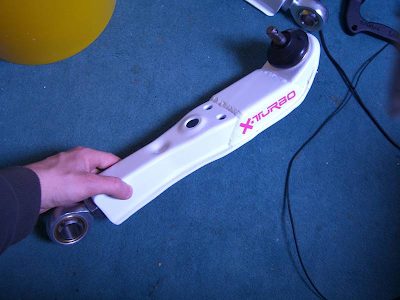

There's other things to consider as well like end link mount locations and the angle of the tension rods. Plus you'll want to make sure your steering doesn't go over center with the extra tire clearance.
IMO the best way is to extend the control arm outboard of the end link and tension rod mounts. That way geometry of the end links and tension rod doesn't change. Some examples:

On the last picture, what is that extra bolt/ mount thing for?
Deuce Cam
Posts: 1346
Location: AZ
Re: Extending Stock Control Arms Discussion
Postby Deuce Cam » Sat Feb 22, 2014 7:16 am
I think they're prototype mcn sport arms that never hit the market.
Are you talking about the extra bolt on top? It's the end link assembly - lower half is a heim joint and the upper half uses stock style bushings for the sway bar connection.
