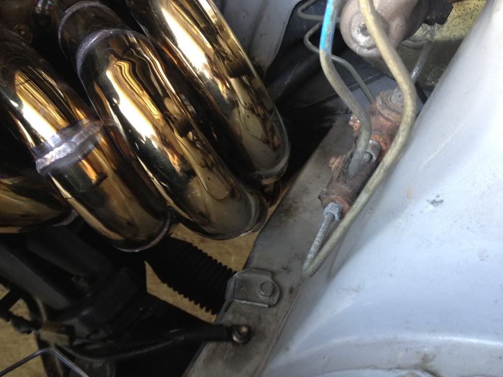

even with cusco mounts i had a lot of issues getting them to fit, had to get an exhaust shop to do it. i own 2 tri y headers and 1 of them did fit better than the other lol.. currently this is the situation (pic below)
other than fitment that looks like it was designed for an engine stand and nothing else... the headers make incredible torque and even mid to top power. after all the trouble, im definitely glad i have 2

The polish on yours is certainly better than mine, which I plan to sort after the build is done. OBX did not do their homework with this, I am glad however that you noticed a difference, I'm looking forward to hearing mine once I've fixed my ST's valve tick

how bad is the valve tick? 20v with open stacks are really loud... you can hear the entire valve train and then you get the common vvt click which makes it sounds like your knocking top end. but im rubbing against the frame rail btw.. the vibration is pretty annoying

so I had a chance to test fit it onto a 16v, hits the distributor quite a bit, it's a lot worse if you're using a smallport distributor. I would highly recommend getting it custom fitted as mentioned above instead of trying to force it in
