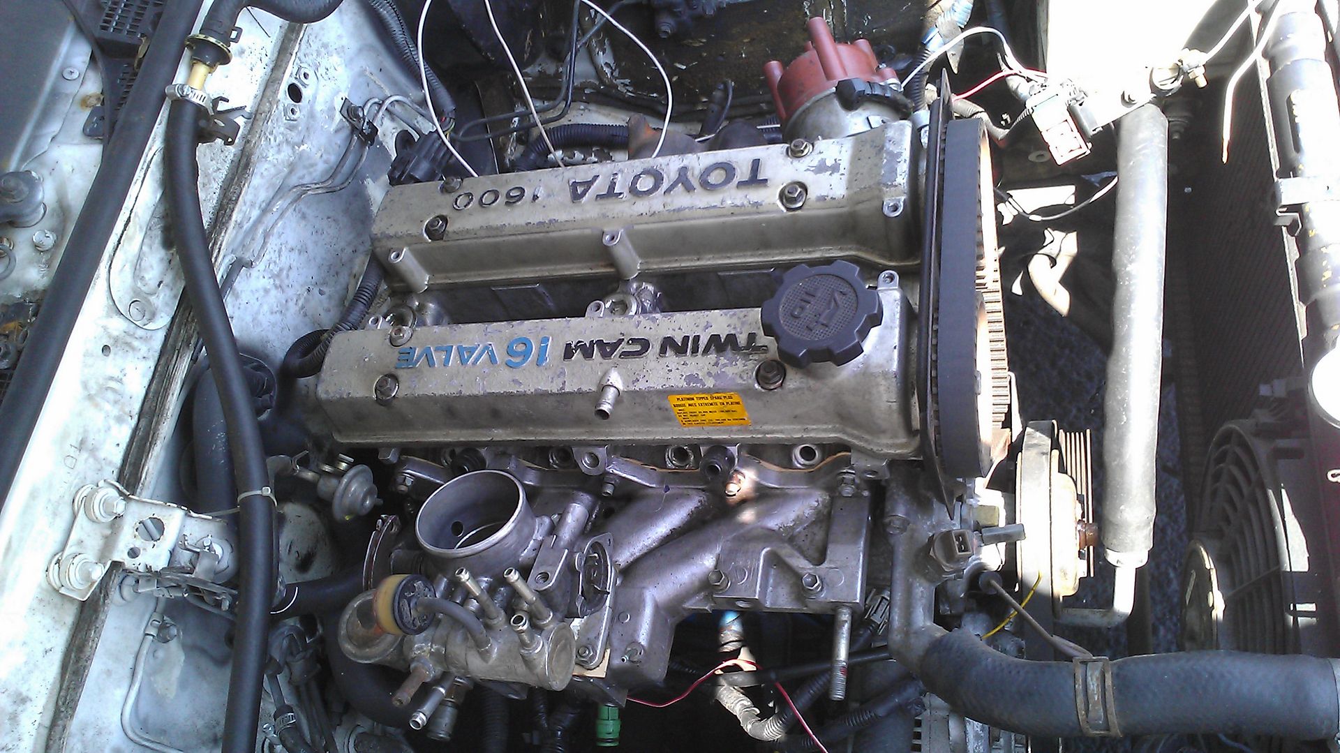

So I came across this ae86 for super cheap...apparently it has a twin cam swap with supercharged head and celica supra diff. I'm not new to engine swaps (my e39 BMW 528 has a 1jz swap) and I have mix and match parts on my 3 other e36s. I love drifting my M3 but ripping out the subframe bc of drifting is annoying. So this brings me to this 86. I love the simplicity but I realize I know nothing of this motor. Hopefully you guys can help...otherwise I'll just throw the 1jz in it and call it a day.
carbd7age

Basically I bought this car unfinished and hacked up. I guess it used to be carburated but now its FI but missing injectors and fuel rail. I don't know what ecu is in there and what has been done to the harness. Ive seen the engine run but it was from a mechanic spraying fuel into the injector holes. The diff has been changed but I don't know how it was done. The parking brake doesn't work and I'm not sure if the headlights pop up. No vacuum lines or spark plug wires installed and unplugged connectors everywhere. Do I try to fix this headache, or should I just get a BT or ST complete swap with unhacked harness and go from there? Maybe use this engine and a megasquirt? What would you guys do? I'm trying to find a starting point so I know where to go in terms of building the car.

The SR5 was built with a 4AC carbed engine. The blue lettering on your engine indicates it is a "bluetop", the lowcompression 1985 version of the 4AGE fuel injected engine. Which was only shipped on the GT-S, and only normally aspirated, never boosted. The boosted engines were used on MR2s, so this engine is a pull from an MR2 or some other mod.
If you read the faq and tech ref sections you should be able to figure out what you've got and what the options are for it. A lot can be interchanged-but some can't, unless you're a machinist with a shop.
When you've got a frankencar that was abandoned before it was fiinished, for whatever reason, you have to consider that some of the parts and installation may be flat out wrong, so assume nothing. Read up, try to identify what you've got (engine, harness, adapters, tranny) before you tear into it.

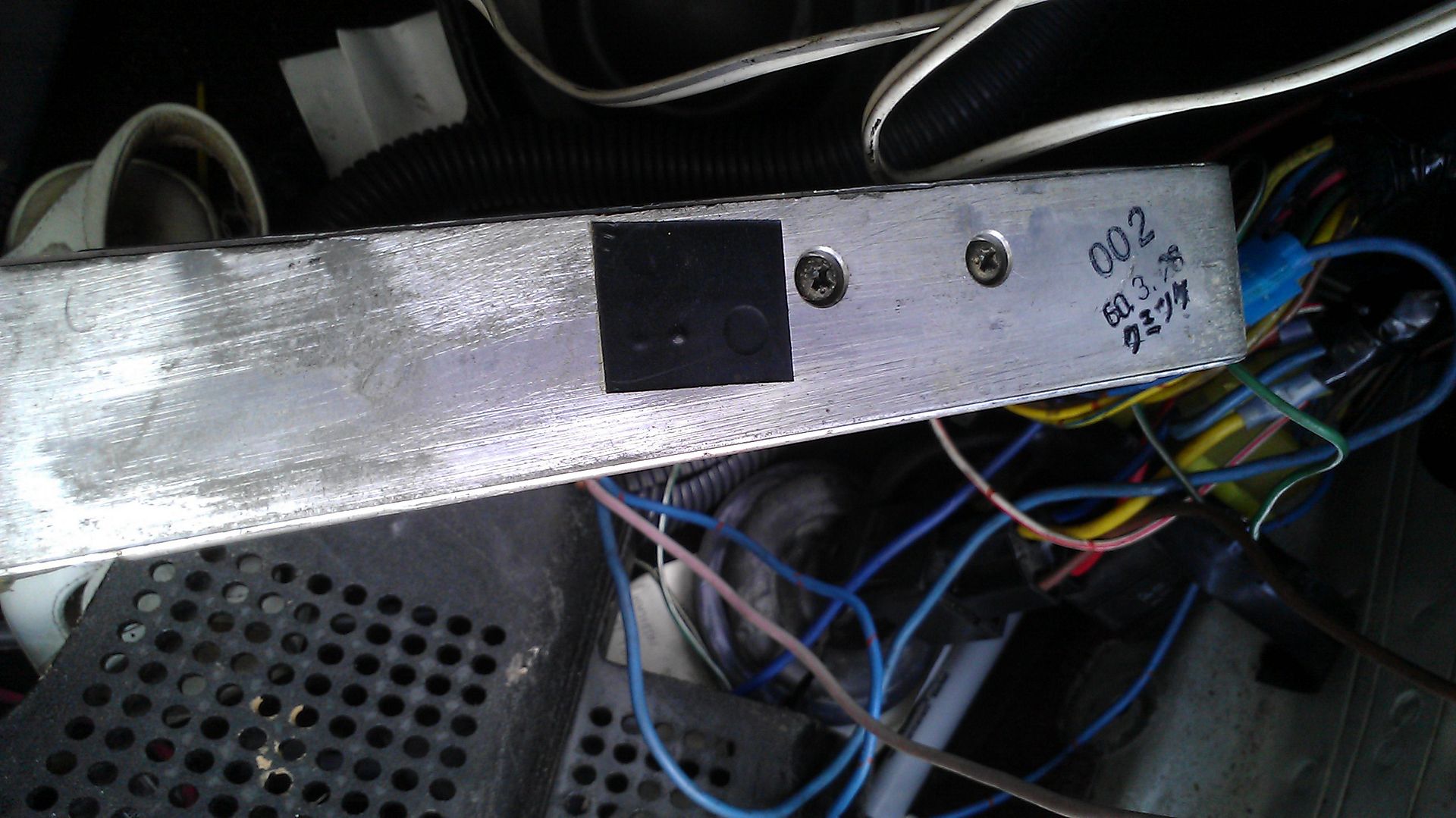

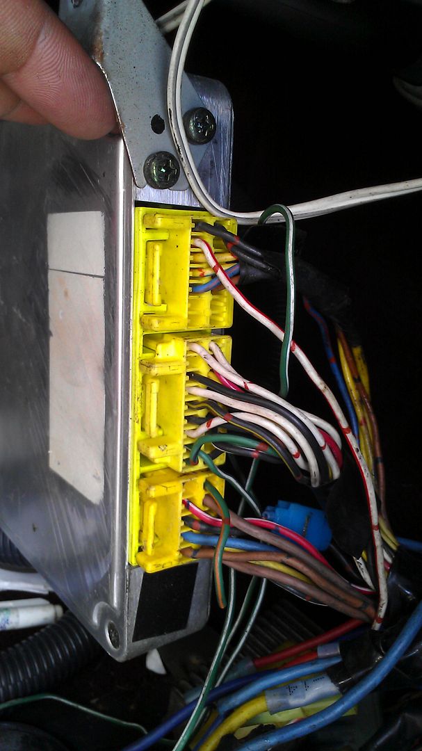

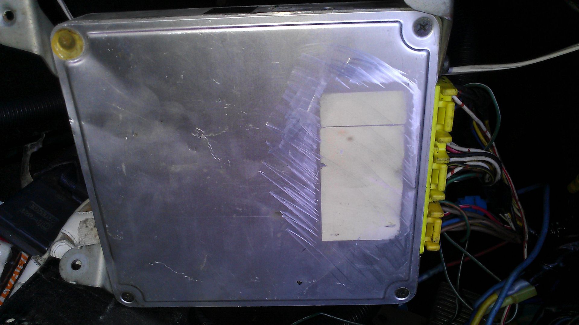

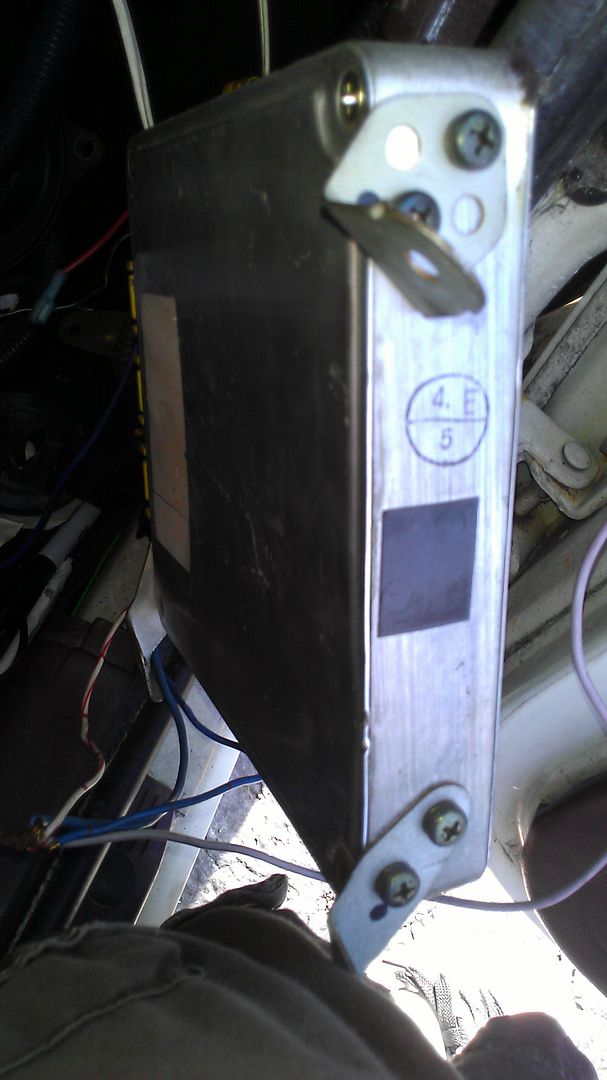

can anyone tell me how to identify this ecu? Sorry about the big ass pics. That last pic has some writing on the right hand corner, you may have to click on the pic then pan right to see it

If you can recognize his ECU, which appears to have had the labels intentionally scraped off, and then figure out what mods were done to his engine, what electronics will rok properly with it, and oh, right, put that on a dyno to test and adjust it if you're going to use a custom ECU...great. DO IT, help him out, don't just tell him to do what he doesn't want to do.

I am starting to get the feeling that when you talk abotu ITBs you are talking about carbed ITBs. If that is the case then you should clarify because there are also EFI ITBs and they are more common than quad carbs in the 4AGE world. In fact if you are talking about quad carbs why not just call them that and save the confusion?
People can get carbs working quite well. They were a great solution for decades. They are antiquated technology at this point though and will never have the performance, efficiency or versatility of EFI. If someone is lucky they might be able to tune a set of carbs to perform roughly as well as L-jetronic EFI but that will change as soon as temp, humidity or any number of other variables change. We won't even get into the effects of elevation.
This page should at least allow him to roughly figure out what ECU he has. Judging by the yellow clips I am going to say a standard 9.4:1 NA 4AGE ECU found in Corollas and MR2s.
http://www.diyautotune.com/diypnp/models.html
He doesn't need a dyno to tune it but he will want a wideband if he plans to run boost. If he really wants to start pushing it knock monitoring and pyrometer would also be good but those are all things he can worry about down the road.
He hasn't yet told us what he wants to do or doesn't want to do so it's presumptuous of you to assume anything of the sort.
Uh, no. A conventional carbed 4AC has limited power and you need more carb to get more power. There have been plenty of posts from members using ITBs. And none of us knows whether his engine is stock compression or stock cams, he's got a homebrewed no one knows what in there.
He has a 4AGE head on that motor going 4AC would be taking four steps backward and putting quad carbs on it would be like taking half a step forward.
All that aside I would love to see a dyno of a stockish to moderately built 4AC that made considerably more power on quad carbs than it did on one properly sized single carb.
I would recomend he find out which bottom end and pistons he has in there which it sounds like he plans to do.
A bore scope will probably be enough for the pistons. Then pull the pan to see what crank and rods.
