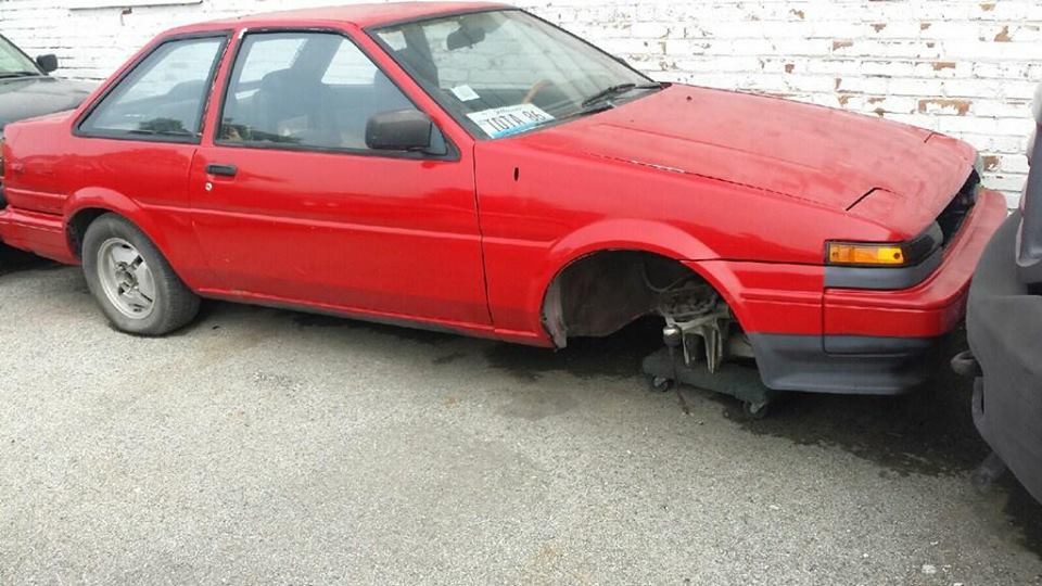

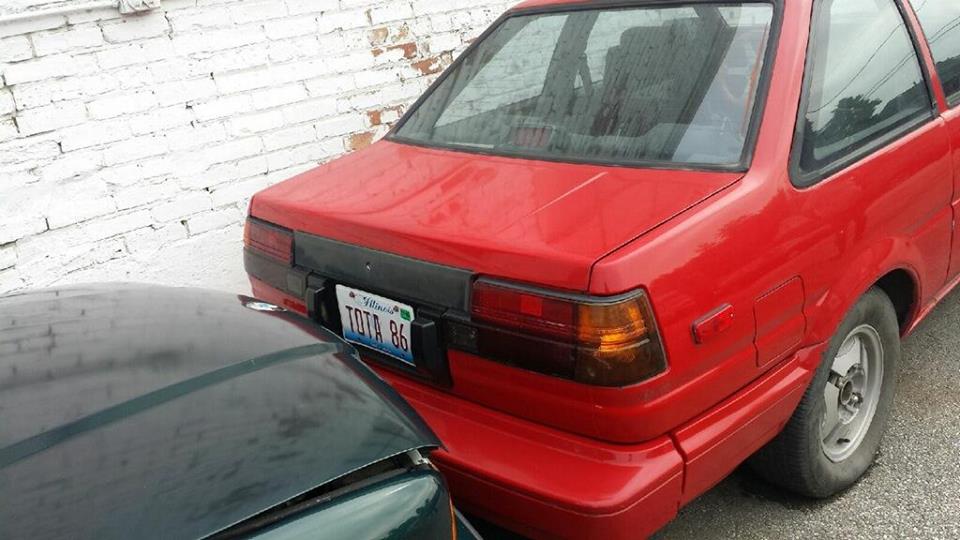

say y'all; i figure i'd show you what my donor (clean ass shell) looks like. These are the only 2 pics i have thus far. but checky check it out. It's got the Sc400 front crossmember which i'll obviously have to swap mine over. Full interior, clean as ****.
