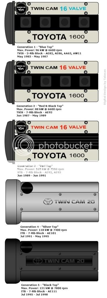

TRY not to use colors on the 16V engines... it gets mixed up and confusing... with that said this photo may help you a bit.
***IF*** the engine is original(1986)... it is 9.4 to 1 compression, 3 rib block with the "smaller" crank and rods, with a largeport head. There is some inaccuracies in the above photo. One of these inaccuracies is 7 rib blocks were available earlier in 1987 then June.
Now for the BIG BUTT..... after 30 years ANYTHING, any combination of 4AGE parts could be in there!

Thanks mate lesson learnt, therefore this car has a GEN 1 4AGE in it. But as I said the engine bay seemed like it hasn't been cleaned for 20 years so I assume that the engine is fully stock.
