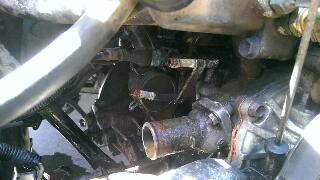

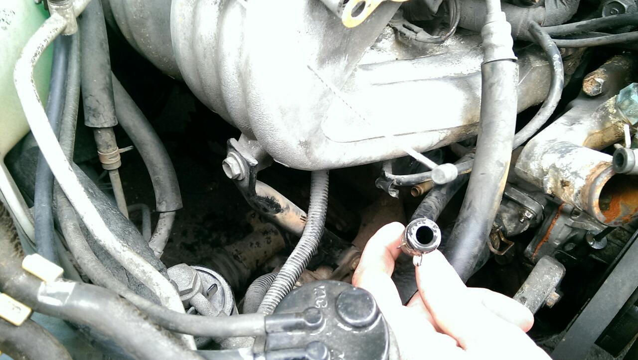

Found a smoking gun. After digging further I found an old post from Jondee with this pictureImage
The out 2 is called the cylinder head rear plate. I took it off and found that mine has two vaccum actuated valves. One is broke as you can see here.Image
The vacuum line was then looped like this [img]http://images.tapatalk-cdn.com/15/04/21/0c4bb0bce20bbc3b5dd04c20bd29cb55.jpg[/img]
Looks like the only thing it can be. I ordered the part and waiting for delivery. Very excited to possibly have the car run normally. Can someone explain what those vacuum valves do? How they work? Thanks for the help.

The IACV feels cold to the touch when the car is running. I can't figure out why there is no flow through it. All the metal lines and hoses are clear. No blockage.

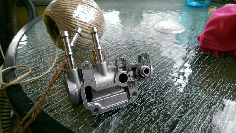

Iacv off. Nothing is clogging it. I tried sticking it in 180 degree water to see if the valve closes. I don't know what to look for. I can still blow air through all the ports.
What am I missing?

jondee86 wrote:This is a brand new USDM set of water tubes...
And this is an old set of JDM water tubes...
Side by side comparison...
The fat pipe is the heater return to the suction side of the water pump,
so this is where the water goes when it leaves the AAV. The skinny pipe
connects to the heater outlet pipe at the back of the head, and this is
where the water for heating the AAV comes from. As you can see, it is
not a very complcated setup, so checking to see where the blockage is
should be quite straight forward ;)
Oh, and at the rear of the head you should have one of these....
You need to check that the little side tube that sends water to the AAV is
not blocked. That would be a good place for a knob of sealeant to get wedged.
Well. Even though I feel like an idiot, it is fixed! The car finally idled normally. The problem was the small metal tube leaving the iacv was blocked by rust and junk. I cleaned it out well and all seemed to work.
Thanks to everyone who helped troubleshoot this problem. You guys were on point with the diagnosis. The first time I checked the pipes, I was rushing and didn't take the time I needed. It was a good learning experience.
