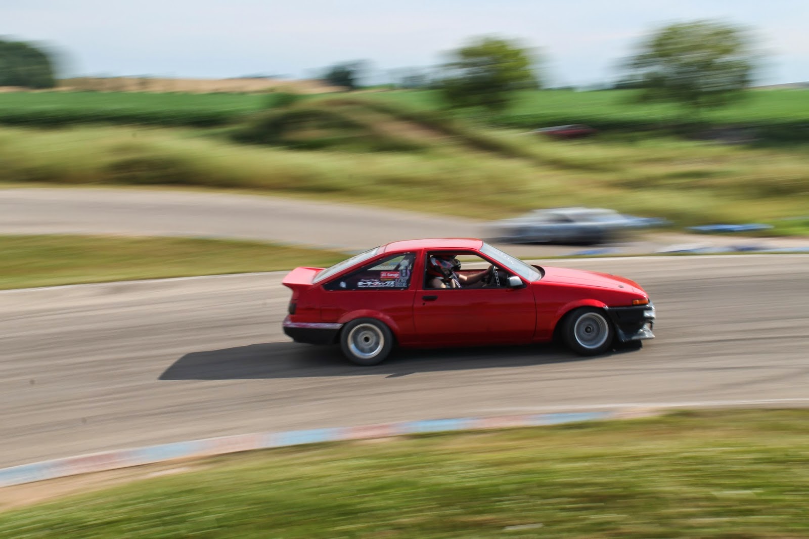

Went to DD49 and had a blast. Bumpers were not finished, but I put them on anyway.
So in addition to those cool pics from the drift day, I have been chipping away at some random stuff to make the car a little bit more friendly to drive around town, since I do like driving this car on the street.
