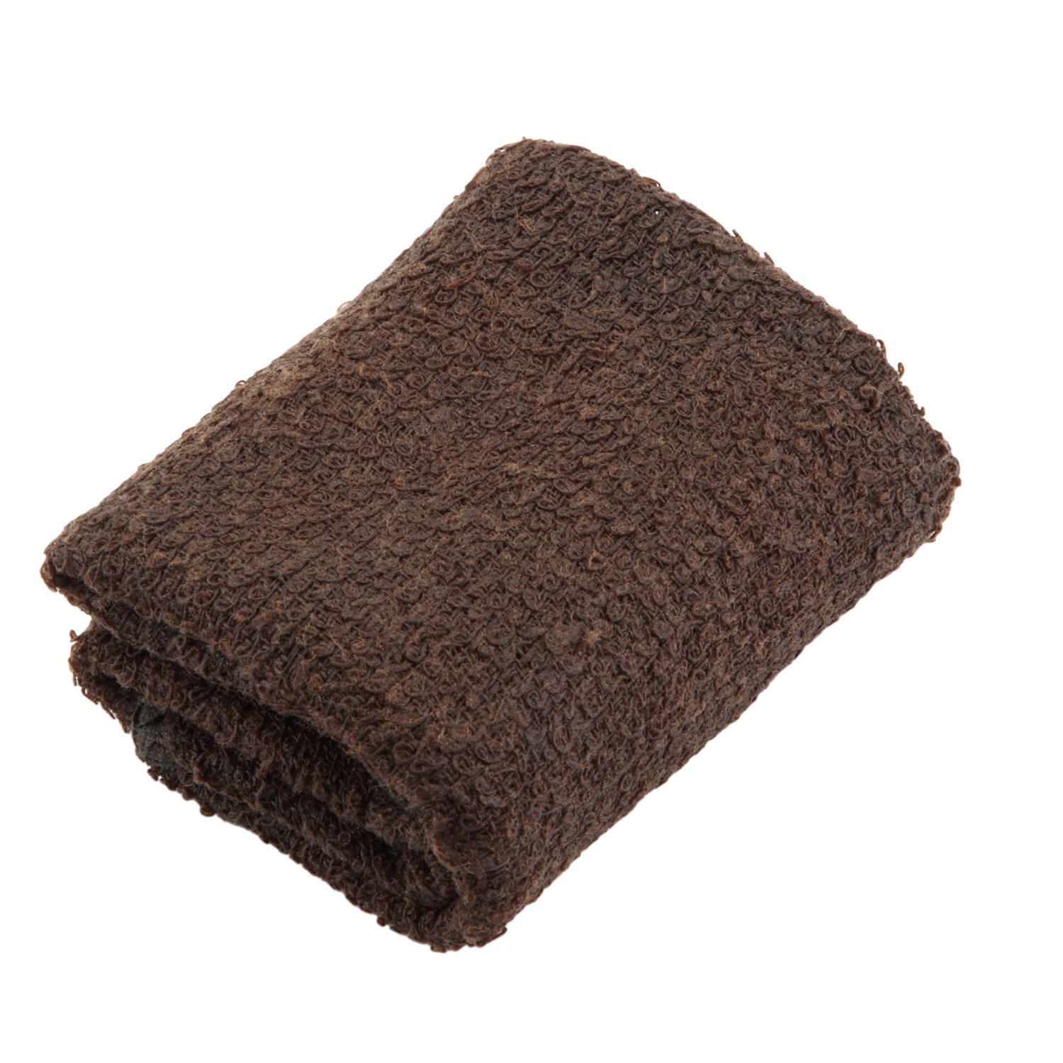

Random rag

Spray Aircraft Paint Stripper on the spot or in this case the entire muffler.
Wait 10-15m and you should see the old paint bubbling up, and being lifted off the surface.
Wipe off with rag, and then.....
