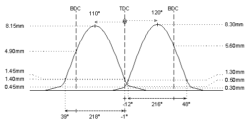

As the title suggests, I'm looking for the intake closing event for a stock Blacktop.
As an example... stock 16V cams have intake closing @ either 51(early), or 44(later)
So, if you have a spec, or found one, for the stock Blacktop cams.... I'd greatly appreciated an answer...........
thanks in advance...

think I may have found it.... although it doesn't specify if it is silvertop, or blacktop....
http://www.catcams.com/products/camshaf ... TUP_id=837
Can anyone confirm these #s???

There's a table down a bit on Bill Sherwood's page listing the 20V cams
http://www.billzilla.org/4agstock.htm
I could have sworn I saw the specs listed on a Levin&Trueno magazine or something like that
Posts: 2218
Location: Portland, Oregon
Re: What is Blacktop's intake valve closing event??
Postby oldeskewltoy » Thu Feb 25, 2016 5:41 pm
jdm86gtz wrote:There's a table down a bit on Bill Sherwood's page listing the 20V cams
Bill does have a goof on his 16V cam timing.... compare his 16V smallport exhaust timing to Toyota's shown above. He shows the cams as being mirror of each other like the early cams are, where Toyota shows slightly changed cam timing...
This makes me feel that Bill's #s are close... but not necessarily accurate. I ASSUME Catcams measured.....????

VVT on or VVT off?
Pursuing the ideal
Posts: 2218
Postby oldeskewltoy » Wed Mar 23, 2016 7:57 am
burdickjp wrote:VVT on or VVT off?
off was my original thought... but both couldn't hurt ;)

I can't find my cam maps and my notebooks are buried from a move :(
From what I remember, Bill's timimng event numbers were within a few (2) degrees for VVT off on the OEM blacktop cams I've measured. I don't remember which way, though.
