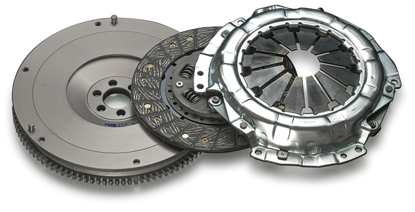

3.6 KG 212mm flywheel. This is the sample. The rest should be here in about 2 months.
https://scontent.fsnc1-1.fna.fbcdn.net/hphotos-xtl1/t31.0-8/12604847_966231336746425_2016244816699927951_o.jpg

and there is always Toda..... 46,000 yen isn't bad.... http://www.toda-racing.co.jp/en/product ... 4ag-3.html
Yoshi.... where do you drill in to that to balance it??

On that pic Yoshi, how much more strength is gained by the extra six mounting screws?

oldeskewltoy wrote:and there is always Toda..... 46,000 yen isn't bad.... http://www.toda-racing.co.jp/en/product ... 4ag-3.html
These will be somewhere in the $150 range to compete with the CBhaus flywheels I used to be able to get.
They come pre balanced at 10k RPM from the factory. Balancing marks are on the back face. Doesn't look like I got pics of the back side before I shipped them out to customers though.
These will also be 212mm instead of 200 to give more torque capability per clutch pressure.
While the Todas are a great product they are about $600 in the US and if you ship from Japan you will likely spend around that once it's landed.
If anyone wants a Toda I can get them as well. But I haven't found many willing to spend that on a flywheel. Plus I really like the idea of being able to run the bigger disk.

sirdeuce wrote:On that pic Yoshi, how much more strength is gained by the extra six mounting screws?
As far as the flywheel it's self goes it won't do much for strength. Perhaps it will give a little more stability and resistance to harmonic deformation but probably not much. As far as strength from breaking bolts it should do quite a lot.
Many people think the bolts hold largely by shear strength. This is also the mindset that leads a lot of people to add dowels on the 6 bolt flywheels to increase shear strength. Dowels are not supposed to be used in this manner. They are really meant for alignment and should not have force applied to them. In single shear they will benefit very little if they do.
Bolts on the other hand get their strength from clamping force. What prevents the flywheel from spinning on the crank is the friction applied by the clamping force. Each 6mm bolt will add approx 3000 lbs of clamping force or a total of 18000 lbs more clamping force to the flywheel.
So it should do quite a lot actually.
2 more similar grade 10mm bolts would add 16,000 - 18,000 lbs more as well but the 6 6mm bolts should distribute the pressure more evenly.

The question was actually a plug for your flywheel. Can you offer an option for a set of bolts with the proper shoulder and thread length? Since the crank isn't drilled already, maybe have one, space permitting, bolt drilled offset to lock in orientation to 1 and 4 TDC, like the SPG pattern used in VW crank/flywheel interface. Not that my 7A build will need it. I'm keeping it pretty mild.

sirdeuce wrote:The question was actually a plug for your flywheel. Can you offer an option for a set of bolts with the proper shoulder and thread length? Since the crank isn't drilled already, maybe have one, space permitting, bolt drilled offset to lock in orientation to 1 and 4 TDC, like the SPG pattern used in VW crank/flywheel interface. Not that my 7A build will need it. I'm keeping it pretty mild.
I will have an add on kit for people who need the extra holding power. It will include bolts and a drill bushing that will fit in the 6mm holes. You would bolt it in place using the 6 main bolts and then use the drill bushing to locate the 6 smaller holes.
You would then tap them and install the supplied bolts.
I am unfamiliar with the SPG setup or what that would be trying to accomplish. Do you have a link that goes into some detail?

SPG was big in the VW arena. Stock VW cranks had a single "gland nut" to hold the flywheel to the crank. To keep the crank and flywheel on the same page VW put 4 little dowels in place. 4 dowels failed miserably when you pumped up the engine. SPG made roller bearing cranks, among other things, for the VW and doubled the number of dowels. One dowel was offset to "key" the crank and flywheel so when they were mated they were good for life, maintaining their balance. Wish we had roller cranks for the 4AG....... I think SPG is now defunct.

sirdeuce wrote:SPG was big in the VW arena. Stock VW cranks had a single "gland nut" to hold the flywheel to the crank. To keep the crank and flywheel on the same page VW put 4 little dowels in place. 4 dowels failed miserably when you pumped up the engine. SPG made roller bearing cranks, among other things, for the VW and doubled the number of dowels. One dowel was offset to "key" the crank and flywheel so when they were mated they were good for life, maintaining their balance. Wish we had roller cranks for the 4AG....... I think SPG is now defunct.
As long as the flywheel is balanced there wouldn't be any need to key it to the crank.
