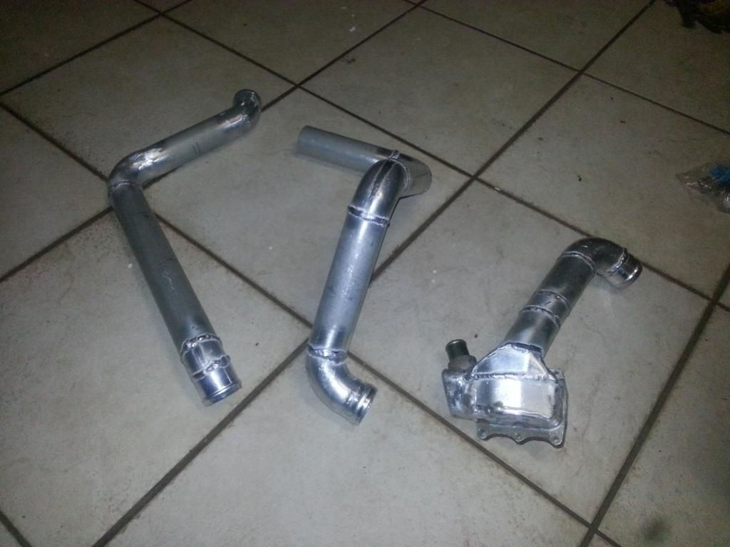

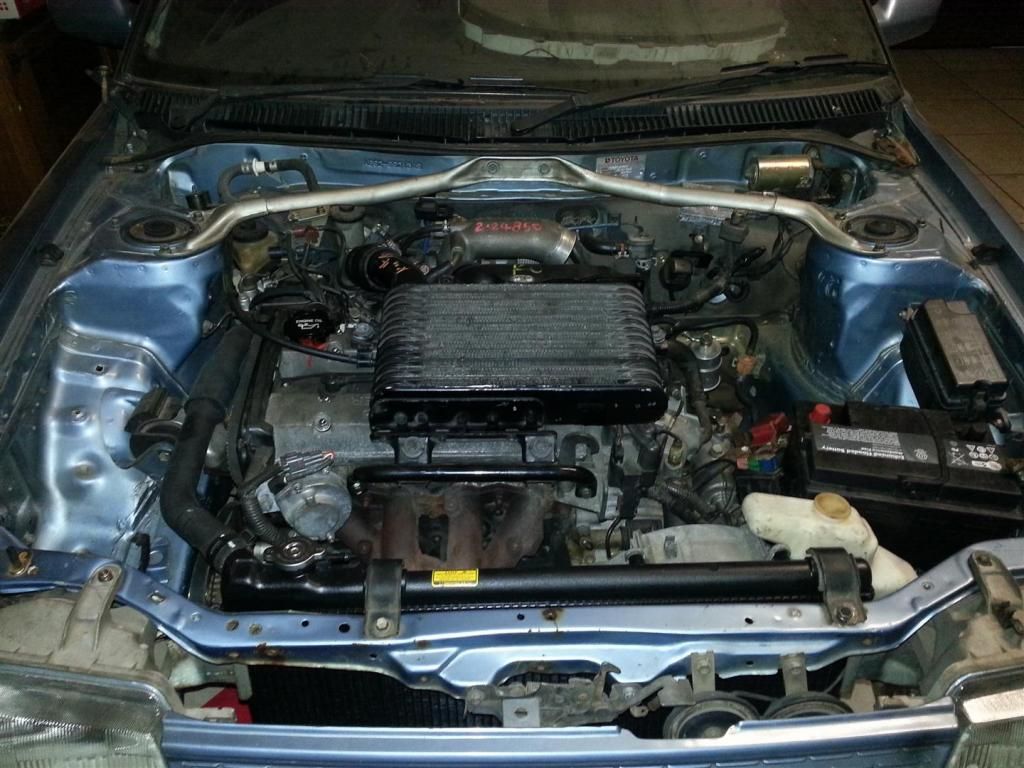

Hi All
I have changed from :
TO
But I am facing a problem now and I dont know if it is related to the piping. (I have also bypassed the FPR VSV) Car seems to run okay when the S/C is not boosting (driving with a light foot).
As soon as thre is some boost from the S/C the ECU seems not be able to figure out what's going on. (as if it cant read positive pressure). Fuel pressure is between 3.5 and 4 bar
Everything was running fine before the piping could this be related to a leak or maybe something I have forgot to connect. Map sensor and the vacuum pipe seems to be fine.
Thanks =]
