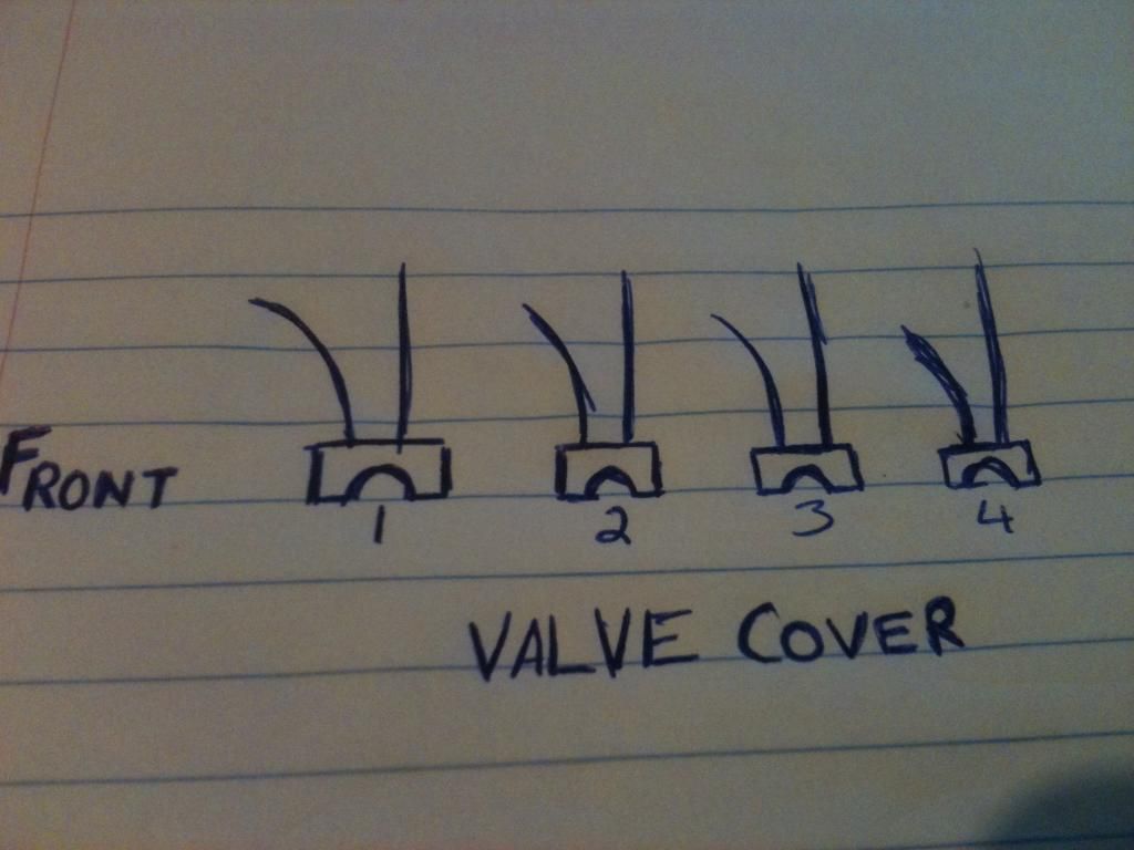

Hello fellow Club4ag-ers! I have an issue with my injector clips on my 16v. What I need to know (for the life of me, I cannot find the answer), is what wire goes to what part of the connector clips at the injectors (the clips are not factory, but the harness is).
Can anyone tell me which color wire goes to each injector clip (by looking at my drawing, I need them in order from injector 1 left to right, and so on for the rest)? Just trying to get this right while I have a day off to work on it. Thanks for your time and help!

Forgot to mention, it's a kouki harness^^^

Awesome, thanks for the info Jon! One last quick question: Are the Red/green for 1+2 injectors, red/green in the actual harness too? Likewise with the Blue/yellow for 3+4 (blue/yellow, not red/green haha)?

The wiring diagram I have shows blue and red leading to the resistor box
and yellow and green going all the way to the ECU. So I would expect that
they would stay the same in the harness. The injectors are wired as pairs
in parallel, so there will only be one blue and one red arriving at the resistor
box, and one yellow and one green connecting to the ECU.
