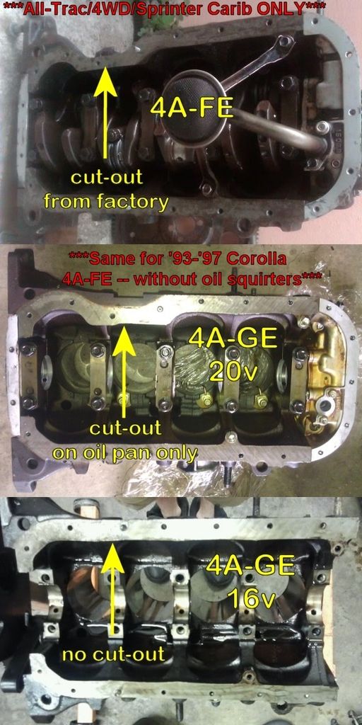

Cool. By the way, what are the differences between the blocks between the 4AFE and the 4AGE? Is it possible to just swap internals and then use the GE head? Or the GZE head and supercharger? Is this a stupid question? The latest model GZE apparently had 165hp and it seems like a S/C would be fun for around town pick-up and go. I know some people are not too keen on supercharging due to turbos giving more power, but seriously, this doesn't need to be a ridiculous machine. I'm not racing it; I just want to have a laugh while I get around town.

ALL 1985(?) to 1992 4A blocks have a rectangle oil pan shape. EXCEPT the Corolla All-Tracs' 4A-FE ('88-'92), which have a cut-out to clear the 5-speed's transfer case. I have no idea what the automatic gearbox is like for the All-Trac. The rest of my comments here pertain to the 5-speed gearbox.
ALL 1993-1997 4A blocks have that same All-Trac-unique OIL PAN cut-out that will clear the transfer case. This includes the 20v blocks, unless someone can prove this wrong. I've seen plenty of pics of the 20v blocks with the cut-out. But there is a bit of a ridge of material that prevents a direct swap onto the All-Trac's gearbox. Justacorolla posted a great link showing what needs to be ground off a 20v block OR a '93-'97 4A-FE block.
16v 4A-GE blocks ALL have the rectangular oil pan design. Physically it will not fit the Corolla All-Trac unless you grind away at the block, oil pan, and part of the transfer case (the latter as a compromise) to make it fit. This removes material from the area where the oil pan seals on the block, and you run a very high risk of oil leaks.
I can't comment on the 7A blocks. I only know that they also have a cut-out on the oil pan that should clear the transfer case, as those engines were also used in the 2nd gen Sprinter Caribs overseas. But I don't know if a ridge of material needs to be ground away like it does on the 20v and AE101 ('93-'97) 4A-FE blocks.

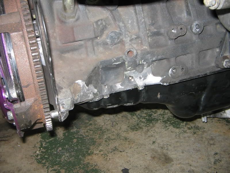

^ This is a 16v 4A-GZE block that was ground down by a great AE95 enthusiast named Kevin, to fit his All-Trac/4WD. You can see how close the oil pan bolts are to the part that was ground away. And below...
