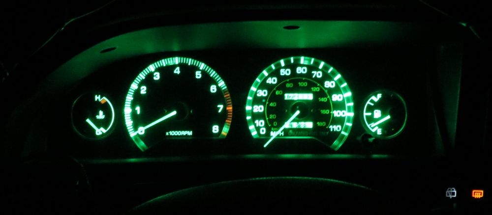

I've got high power, 360° LEDs in my AE95 cluster:
Of course the camera couldn't take a decent pic in full darkness. The dash dimmer can cut down on that intense brightness. I've got every interior (except low gas alert) and exterior (except headlights) replaced with LEDs.
