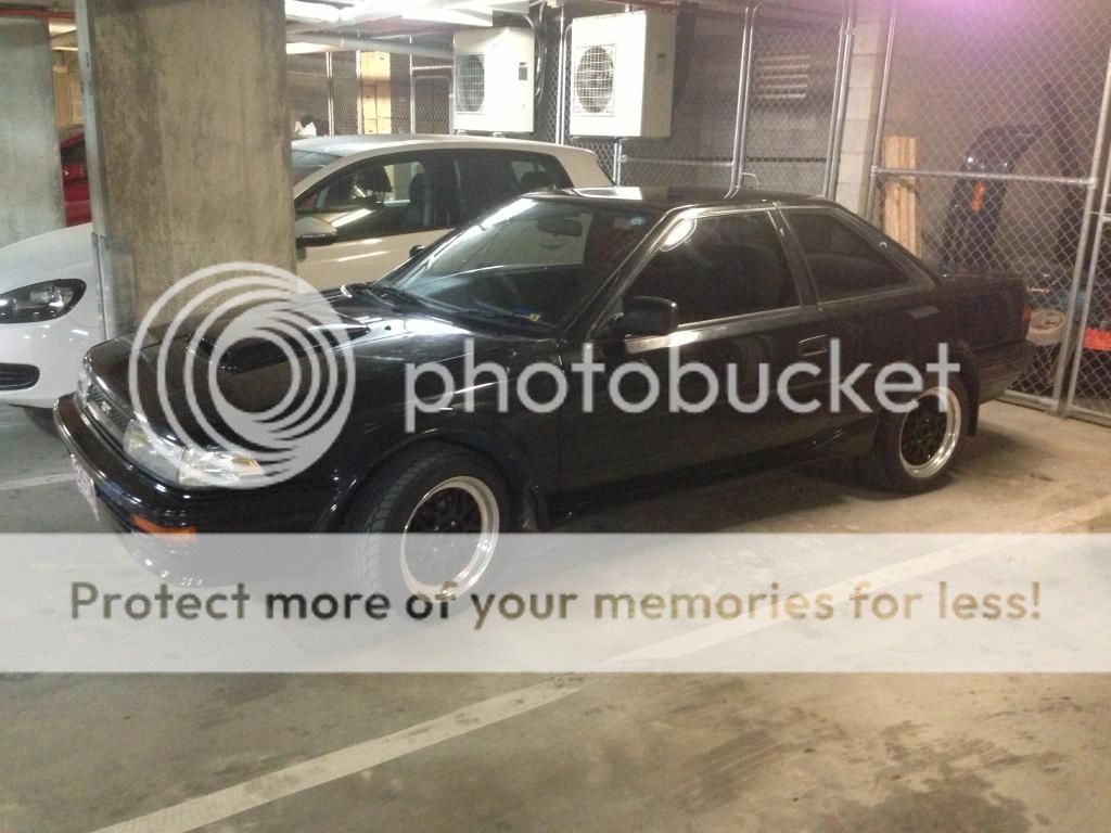

New to the forums. Recently bought a 1989 levin gt-z, photo attached. When I got it the air conditioning didn't work and the previous owned had never had it work. Also it had never been converted to r134 gas or whatever it is.
So i got the conversion and re-gas done today, they told me the compressor is pretty much dead, sourcing a new one which isn't a big drama.
The problem is, i left the air con shop with the air con blasting, the car felt a lot slower on boost, supercharger almost felt non existent. And when i was idling at the lights the car actually stalled, and when i mean stall i mean that it stopped running without me even noticing. Didn't jerk or anything. Then when i stopped at another intersection it did the same, and then it happened as i was driving down the road and was turning right. the car outright just stopped and i lost all power steering and had to slam the breaks on so as to not crash.
