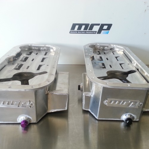

The other... collecting parts for the block build :shock:
along with MRP rods....
and MRP oil pan
more to come....... :D

Postby Rogue-AE95 » Fri Oct 20, 2017 6:15 pm
9A-FE?? The fact that the rods are MRP makes me think of their stroker kits.
Forged GE pistons, or custom FE ones?
Never knew the Euro cam was different. There was also a nicer FE exhaust manifold, UK or Euro. If I recall correctly you got one for your built-up 4A-FE.

Postby oldeskewltoy » Sat Oct 21, 2017 10:52 am
Rogue-AE95 wrote:9A-FE?? The fact that the rods are MRP makes me think of their stroker kits.
keeping the stroke as is, these are MRP's 7A replacement rods, not a stroker rod
custom pistons....
based on a chamber casting
I then had a piston designed based on the casting
As to the exhaust side, this engine will be running a small turbo, so the later euro manifold will not suffice........
