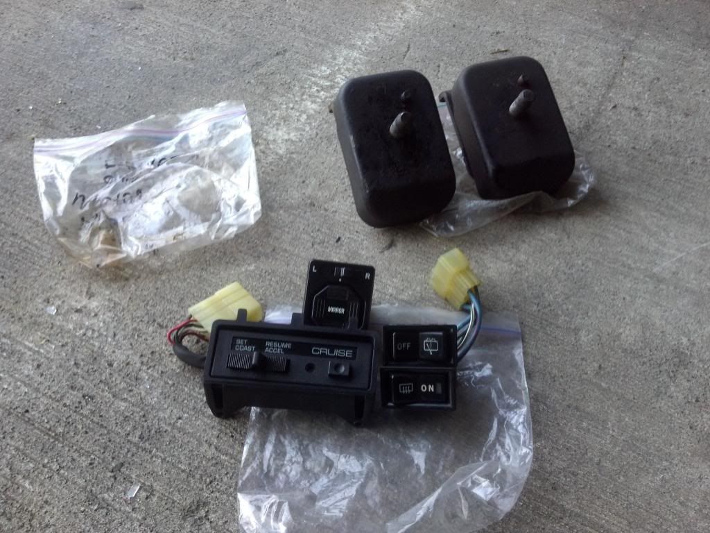

Now I'm not looking for the cruise "box" option (that mounts in the coin holder slot to the left of the steering wheel) personally, I'm going after utilizing the cruise stalk that mounts on the combination switch; I'm not sure if the "box" type was used on the earlier models, later models, or "release" models..
"Stalk" type:
"Box" type:
Another "box" type:
Here are two things I am wondering:
How similar is the AW11 cruise system to the AE88/86 systems?
What is the difference between using a "stalk" type, and using the "box" type? (Seeing as how the stalk type only uses what seems to be physical inputs, the wiring that goes to the stalk or box might be different, but whatever they plug into should have the same connector type as they more than likely use the same control mechanism and plug in the same..).
Edit: nevermind, the stalk and box type have different connectors. The Stalk type looks like it plugs right into the cruise ECU, or maybe the stock wiring harness that the turn signals normally use?

The other issue I'm having is sourcing this auto drive switch.
https://www.toyotapartsdeal.com/oem/toy ... 12010.html
On parts deal, it shows fitment as
"Toyota
Corolla
1984-1987
DX, GTS, SR5
4 Cyl 1.6L
4AC, 4AGEC; AE86"
So It should work on my chassis, but the vin-look up is saying it won't.. Also, there is no telling how this is supposed to mount. There are no part call-outs on the bracket with this switch.
Anywho, right now just trying to figure out how every mounts and sits. The GT-S is just now getting all intake stuff back on, so it's a big work in progress.
