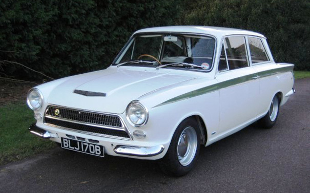

Before I fired the engine I cranked the engine with out plugs. If I remember correctly it was 60 pounds using the starter. I'm in the process of pulling the engine to access the pump and check the relief valve piston.
Thanks for your feed back, I'll let you know what I find.
FYI This engine is in a 65 mk1 cortina.

Ahh... I think the piston is supposed to slide in the bore under its own weight, so yours
might have got jammed with a bit of flash from the pump casting ? Anyway, good find
and since you have it apart well worth checking bearings for any clues as to why oil is
having a hard time getting back to the sump.
Back in the day these were racing with 100hp at the rear wheels, and considered quick :)
