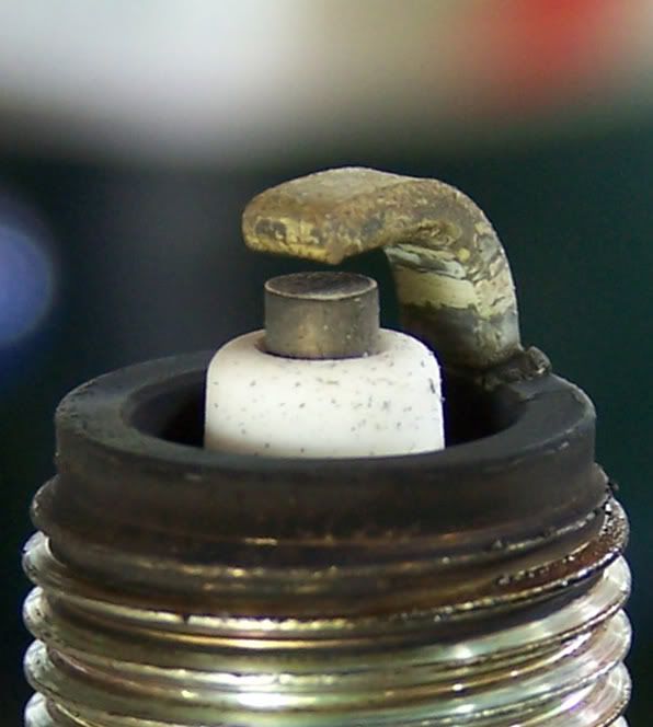

If you think that you may be getting some detonation, look for "salt and pepper"
on the porcelein insulator. These are black and silver specks of carbon and
aluminum fused to the surface. The silver specks may appear as tiny metallic
balls when examined under magnification. This picture shows the kind of
markings that are typical of incipient detonation.
Detonation can remove bits of carbon from the piston top, and will usually be
seen as "sandblasting" or surface pitting in the squish areas. I can't remember
if you have an aftermarket ECU ? If you do you might want to take a look at
how much ignition advance you are running.
